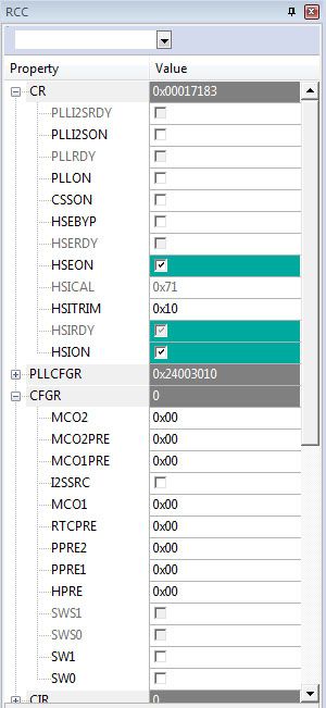

CMSIS startup turn on the HSI, and HSE. After timeout (because plate don't have HSE, and flag HSE RDY not set) SYSCLK switch to HSI directly.
I need the timer clk not lower 50 MHz, therefore i need the SYSCLK from PLL

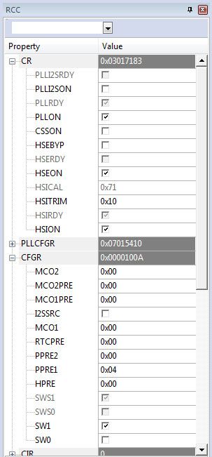

In first screenshot - RCC regs after startup: HSI on, HSI ready, HSE on, HSE not ready, PLL off. SW bits - 00 (SYSCLK is HSI)

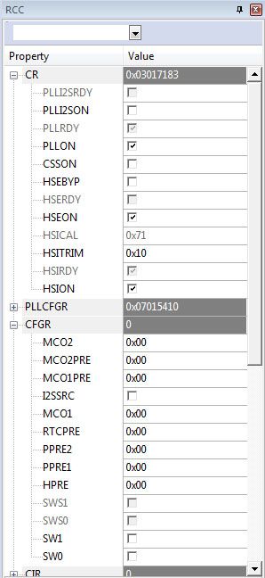

Second screenshot - set the PLL configuration. M = 16, N = 366, P = 4, Q = 7
PLL On and PLL ready
Last screenshot - after execute command RCC->CFGR |= RCC_CFGR_SW_1;
after this program fall to handler (in disassemble window infinite sequence MOVS r0, r0)
