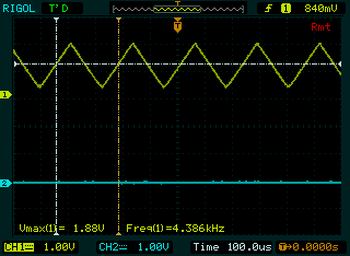

Hello community,
Actually I evaluating DAC on NucF334R8.
DAC1
_
Channel1
 seems to work
but I am not able getting
DAC2
_
Cannel1
 (Pin
PA6
) to work.
 I created the C Framework with STMCubeMX 4.4.0 - both channels with equal settings.

DAC1
 - yellow;
DAC2
 - blue

    Probably not both DAC1_CHANNEL_1

    Tried to debug and compare register settings (DAC1 vs. DAC2) ?
    Some external hardware on the DAC2 output pin ? The DAC is of high impedance, so very sensitive.

    Hello - no load on PA_4 and PA_6 - only oscilloscope is connected.
    I compared DAC1 versus DAC2 register:
    DAC1_CR@0x40007400 is right (0xB85) initialized.
    DAC2_CR@0x40009800 is 0x17. SO WAVE1 bits and MAMP1 Bits are all '0'.
    And I am not able to set them manually in debug session.
    In contrast DAC1_CR register bits could set manually in debug session.
    I am a newbie in embedded programming - sorry for my unhandy.

    In contrast to stm32f40x devices, the f334 has separate clock enable bits for the two DAC channels.
    So can you check RCC_APB1ENR, Bits 26 and 29 when your code tries to configure the DACs ?
    According to your description, I would expect bit 26 to be zero, probably representing another CubeMX bug.
    BTW, it's always a good idea to download the reference manual and datasheet of the MCU you are working with, if you did not already.
    Bit 26 and Bit 29 of APB1ENR Register are 1
    Yes I did but I found nothing that's would fit to the problem.
    It seems that the WAVE1 bits and MAMP1 Bits of the DAC2_CR register are reseted to zero after I set them manually. No idea why...
    That is the usual behavior if the clock of that peripheral had not been enabled previously.
    But as you reported, both enable bits in APB1ENR are set.
    I had only used the DAC of F05x, F10x and F4xx, so not sure what else is different.
    I would have recommended to try a StandardPeripheralLibrary example (not CubeMX) but that seems not to exist for this MCU variant.
    Thank you ST, so much for the StdPeriphLib support ...

    Looking at the ref.manual and your code, there is another significant difference of the DAC peripheral, compared to other/older MCUs.
    The DAC1 of the F334 has two channels, which could be operated independently or simultaneously. The DAC2 has only one channel, i.e. the old-fashioned ST DAC peripheral.
    For that reason, the peripheral registers are necessarily different.
    In your place, I would try to setup another project, utilizing ch1 and ch2 of DAC1, instead of DAC1 and DAC2. I still believe CubeMX might expose some bug here ...
