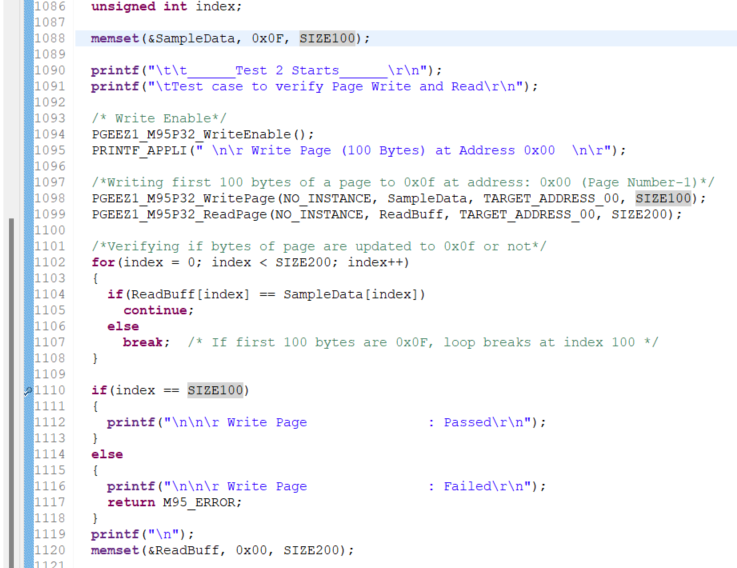

 So, I have followed the structure for my board STM32L4R5 IT6 and I don't have error in my program.

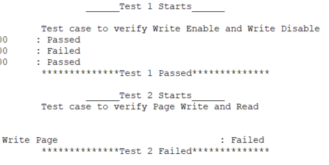

My problem is, I can't get  my expected result from EEPROM and program breaks after Test 2.
because size of index is never be equal "SIZE100" in "app_x-cube-eeprma1.c"!

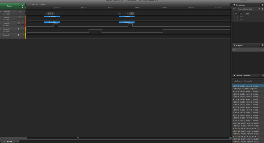

I have used Logic Analyzer as you can see MISO is always ZERO!
I don't know where problem is!
