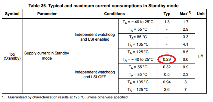

Hello, I got stuck in a power mode on Nucleo-L053R8 for a week. My desire is going to make this board consume an energy lowest as possible when it is on standby mode. I used this code
/*Disable clock to unused peripheral*/
__GPIOC_CLK_DISABLE();
__GPIOH_CLK_DISABLE();
__GPIOA_CLK_DISABLE();
__GPIOB_CLK_DISABLE();
__GPIOD_CLK_DISABLE();
__SYSCFG_CLK_DISABLE();
__PWR_CLK_DISABLE();
SysTick->CTRL=0x00;
HAL_PWR_EnableWakeUpPin(PWR_WAKEUP_PIN2); __HAL_PWR_CLEAR_FLAG(PWR_FLAG_WU);
HAL_PWR_EnterSTANDBYMode();
I got 18 uA on my ammeter but reference manual claims only 0.27 uA so what else do I need to turn off  to get lowest power consumption as possible.

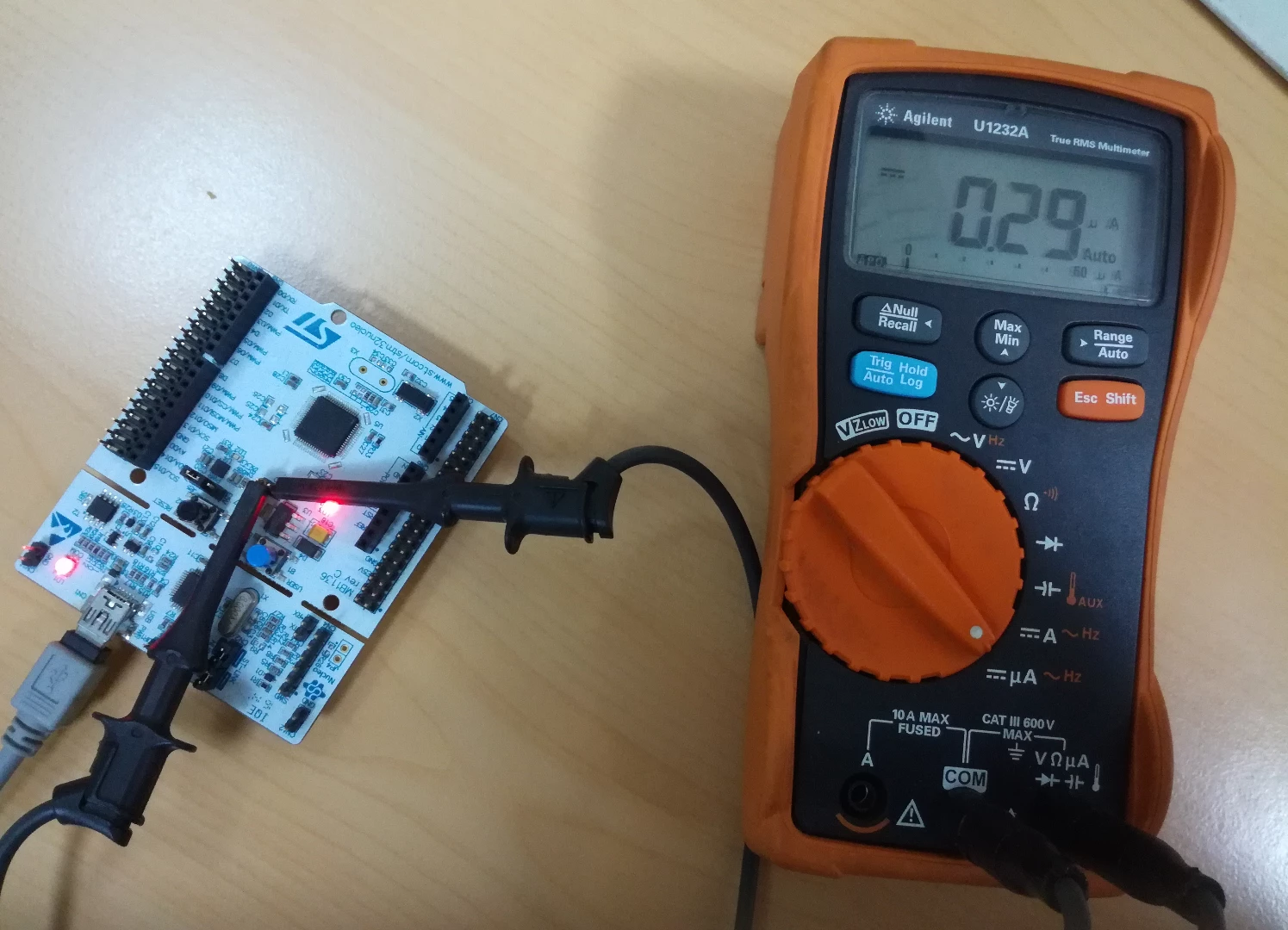

Best answer by Khouloud GARSI
Posted on January 27, 2017 at 15:01
Hello everyone,
Please refer to the ''PWR_STANDBY'' example provided when downloading the
http://www.st.com/content/st_com/en/products/embedded-software/mcus-embedded-software/stm32-embedded-software/stm32cube-embedded-software/stm32cubel0.html
package:
STM32Cube_FW_L0_V1.8.0\Projects\STM32L053R8-Nucleo\Examples\PWR\PWR_STANDBY0690X00000606ALQAY.png
The Idd=0.29µA; which is with the same as the value on the datasheet.
Khouloud

Nathapol Tanomsup
January 30, 2017
Posted on January 30, 2017 at 07:01
Hi, Khouloud
Today, I used an example from
/external-link.jspa?url=http%3A%2F%2Fwww.st.com%2Fcontent%2Fst_com%2Fen%2Fproducts%2Fembedded-software%2Fmcus-embedded-software%2Fstm32-embedded-software%2Fstm32cube-embedded-software%2Fstm32cubel0.html
package but I got this. I don't think it works fine.
Nathapol Tanomsup
January 30, 2017
Posted on January 30, 2017 at 08:52
Finally, I got it. Thanks for helping.
