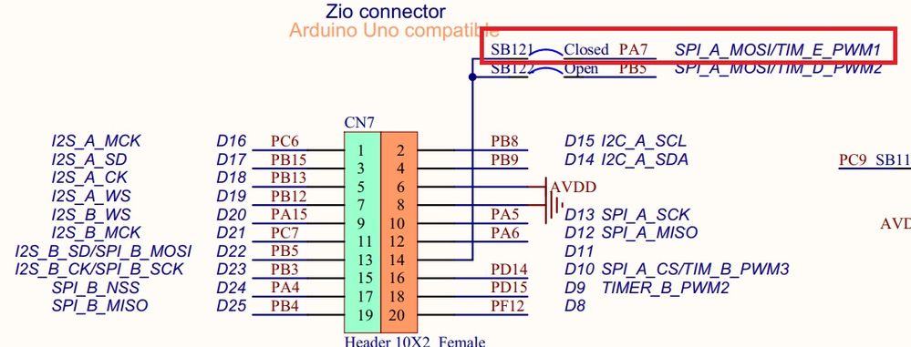

Thank you TDK,
In the link you send me, in the MB1137 PDF - "nucleo-144 for everything" the text on the schematic around the arduino connector is misleading x(
I changed the pins allocations and now it works fine!
What is misleading about it? I see you have posted a screenshot with a red rectangle, but I see no issue with what's in the rectangle.

>>where do I find the schematic for nucleo-f756ZG ???
I don't think there is one specifically, the MB1137 is the primary reference, the BoM for the F756ZG specifically might call out fitted/not-fitted component and jumper level differences.
ST has fairly consistent pin usage across the 144-pin models
