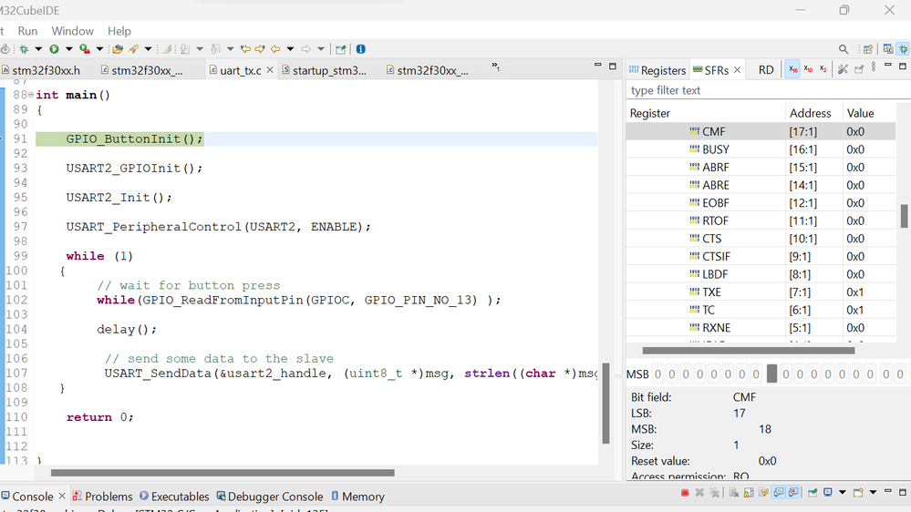

I have a problem where Im developing a bare metal USART Send Data for stm32f302r8 nucleo board. Im sending on USART2 which is PA2 and PA3 through the virtual COM. The TDR register is updating 1 byte by 1 byte. But, the TeraTerm is not showing any data. I have checked the nucleo board datasheet where the Virtual COM is enabled by default and I dont think I need to do any rework on the board.

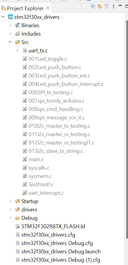

Here is the project:
https://drive.google.com/drive/folders/1XBS8sRM1MYGMVE_CQiCMaR59pj58yTBV?usp=drive_link
You just need to build the uart_tx.c from the Src folder:
I am not able to get your code to transmit to the outside world even when TDR is loaded with data. So it's something in your custom code that you've done incorrectly. With HAL UART driver it works just fine. See what the HAL driver does that you're not doing when initializing the UART.

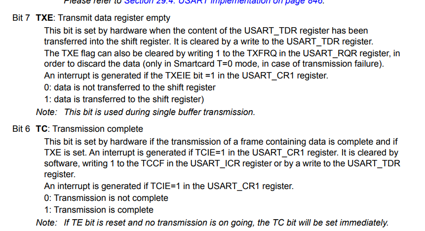

I have found something, why when I just click Start debugging, the TXE Flag is already SET? The program is not yet executed even 1 line. Does that mean the communication is taken over by other process?
