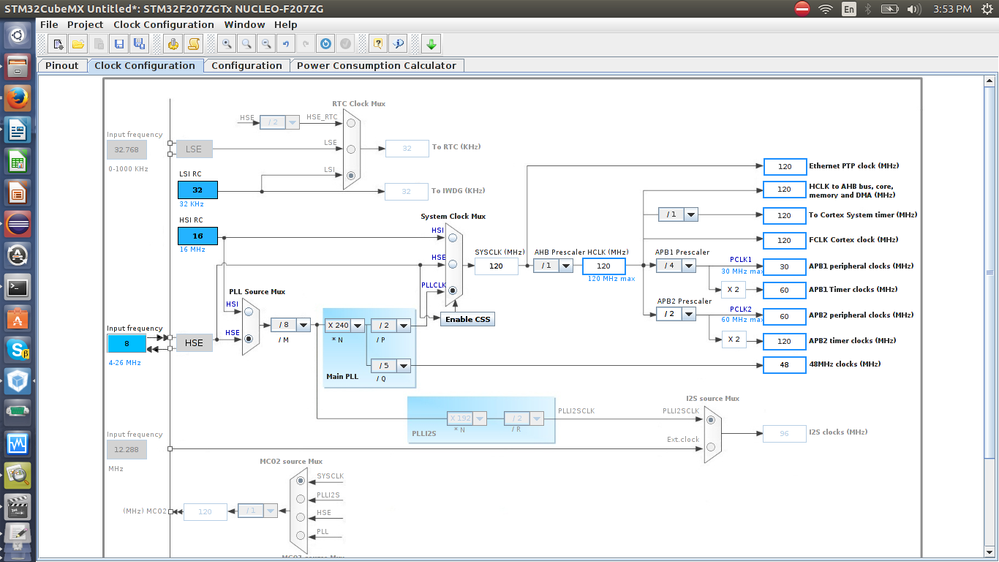

Posted on May 22, 2017 at 12:58
Hi, I am using STM32CubeMX for generating code and using SW4STM32 IDE.
I have configured cubeMX for CDC and generated an initialization code.
In that I have called CDC_Receive_FS(),CDC_Transmit_FS() functions as below.
uint8_t HiMsg[]=''Start\r\n'';
CDC_Transmit_FS(HiMsg,strlen(HiMsg));
HAL_Delay(500);
while(1)
HAL_GPIO_TogglePin(GPIOB,GPIO_PIN_0);
L1= strlen(myBuffer);
 status = CDC_Receive_FS(myBuffer, 5);
CDC_Transmit_FS(myBuffer, 7);
HAL_Delay(3000);
then I compiled and flashed but that wasn't working.
Posted on May 23, 2017 at 07:24
What is the Heap size and Stack size you have ?
You want to increase the Heap size and Stack size.

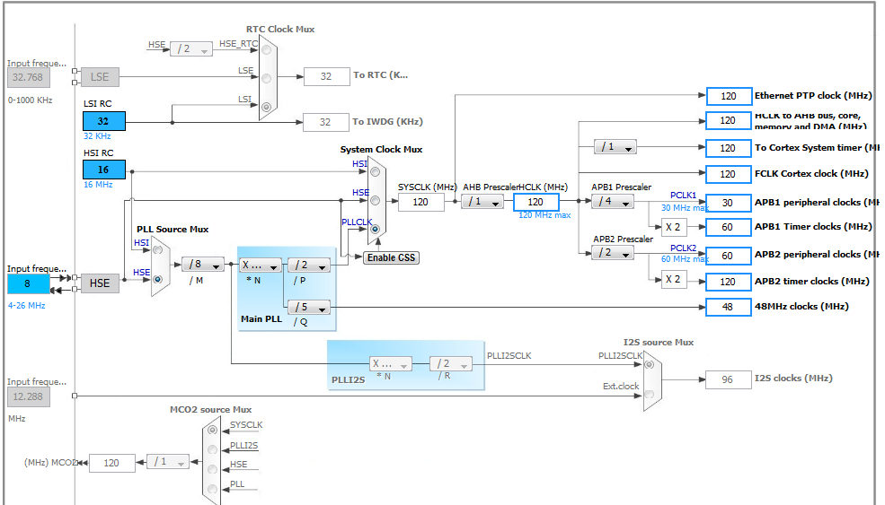

Posted on May 23, 2017 at 07:55
Yes.I have increased heap and stack sizes..when HCLK is 120 MHz it is not working ,but when I am using HSI for sys and HCLK then it is working
Posted on May 23, 2017 at 08:10
It's also working ....

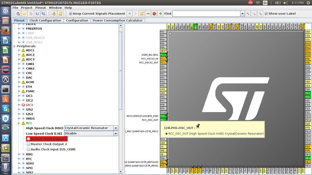

Posted on May 23, 2017 at 08:23
I tried the same but NO it isn't working for me...It doesn't pass SystemClock_Config(),Is there any jumper setting I have to do?
