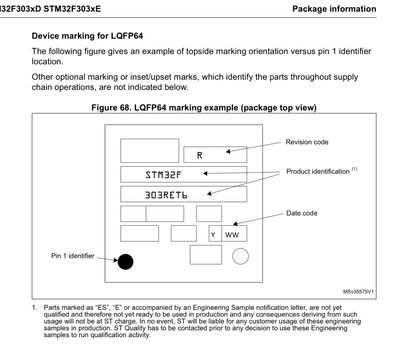

if you can have a picture of the device marking as below :
Thank you

STOne-32Best answer
March 8, 2024
Dear @Ukazu ,
We confirm the part is genuine and we shipped it to our distributor DigiKey . So it might be a connection issue  due to hardware power supply or anything else you need to investigate. If you can Try with our STM32CubeProgrammer and have the log file please .
Cheers,
STOne-32
