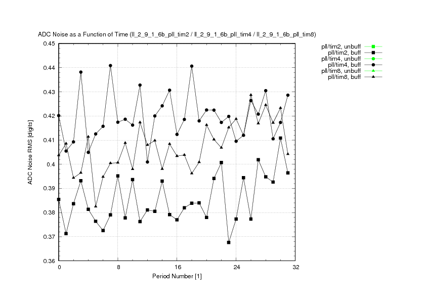

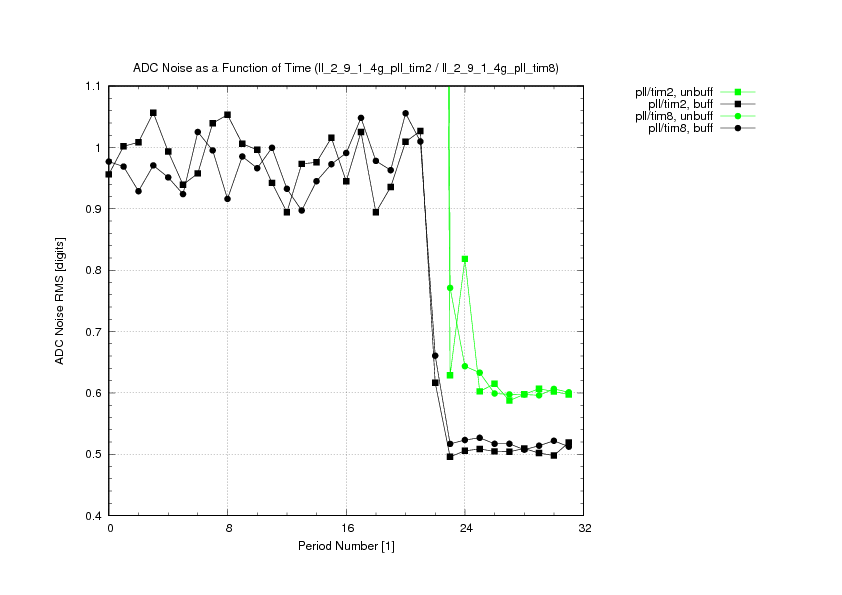

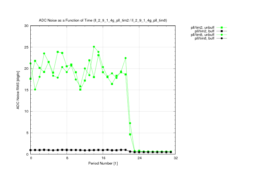

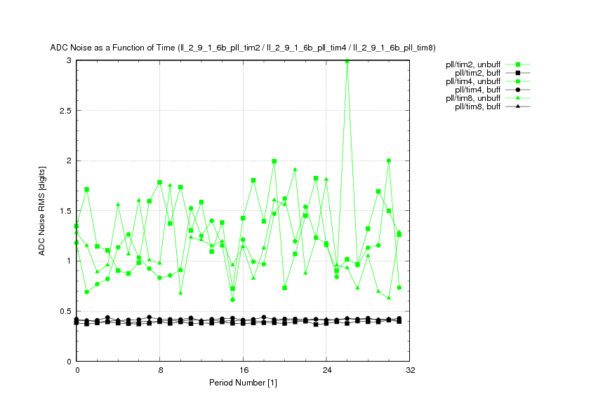

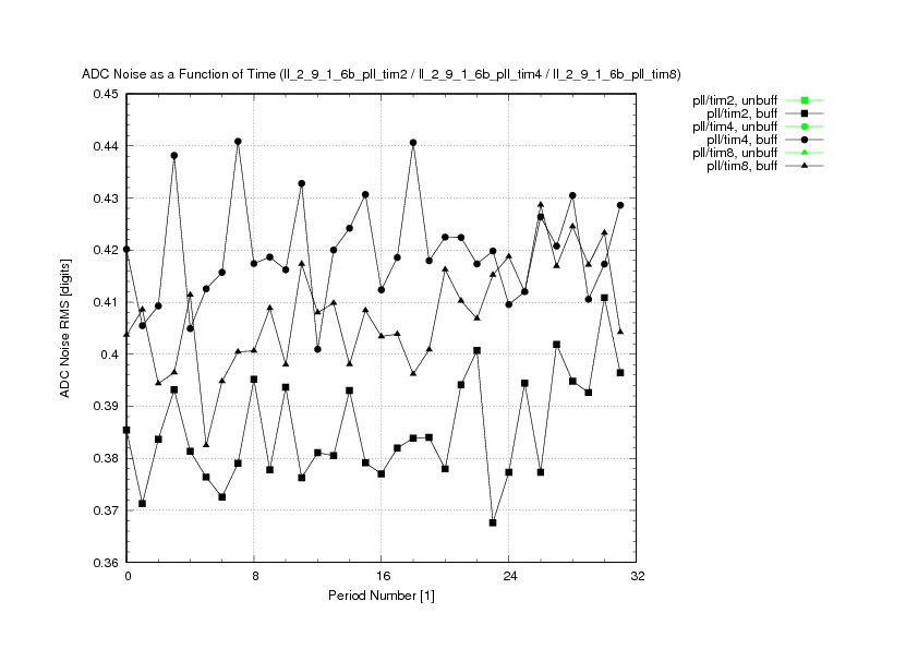

    A picture is worth a thousand words. Four pictures are even better. To give you an idea of what you should possibly consider if you are facing A/D noise I browsed my old records.
    This is, where I started. The PL2303TA was bustling about up to period 22 to recover from the 1 MBaud / 32 KByte transmission of the most recent cycle. The RMS noise of the unbuffered (green) system went up to about 20 digits. Keep in mind that the noise of the perfect system is ? 0.29. Buffering (using the internal OpAmp) helped a lot. To investigate the data in the idle period of the PL2303TA, I zoomed the y-scale:

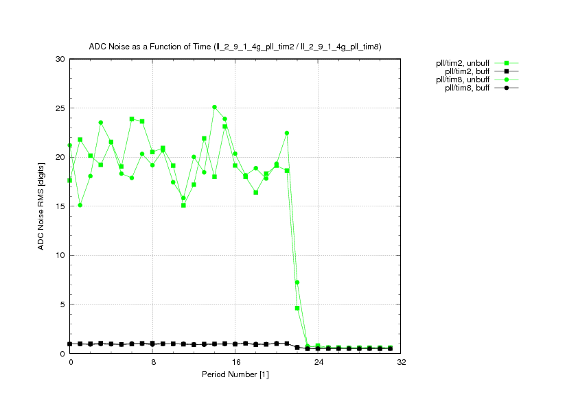

    Same graph as above, just enlarged. After taming the interface (reducing the transmission speed to 19200 Baud), things look much better:
    Now the buffered systems approach the theoretical limit of 0.29. Though the CPU was stopped, I required the timers for triggering the ADC. I tried TIM2, TIM4, and TIM8. The following is a zoomed plot for the buffered systems:
    The graph suggests that the noise could depend on the timer. But to prove that, more measurements would be required. My application used TIM2.

    I'm a little confused by your charts. When it says 'unbuffered' are you talking about the A-D input pin coming from a passive source vs coming from the output of an op-amp? If so, I would expect the noise to be much higher if not being driven by an op-amp. If that's the case, then your chart shows that the buffered version had only about 1 digit of noise on it. (even during the time that the PL2303TA was cranking away) I'm driving the ADC input with an op amp through a 300 ohm resistor and cap to ground, as an LPF. The op amp is powered from the VAA rail. (and for these tests, the signals into the op amps are all flat DC)
    The troubling part for me is 'I tried to use SysTick for triggering. For that I had to keep up the CPU running. The results were so bad that I even did not record them ☹.'
    I can't run the ADC very slowly, and can't shut down the MCU during conversion. I have 5 channels that must be converted constantly, and at as high a speed as possible. The MCU is busy all the time doing other things. I have a 10Megabaud SPI port transmitting about 70% of the time, two I2C ports (100K) reading and writing several hundred times per second, several signals coming in at between 100Hz and 30KHz causing interrupts, several signals going to and from a CPLD. And I haven't even activated the SDMMC port yet, which will be needed.
    I did manage to reduce the noise a little bit last night (about 1/2 a bit) by playing with the clocks. I originally tried either the MSI or HSI going into the PLL to make an 80MHz Sysclk, and the ADC using either that or the equivalent signal generated by the PLLSAI1 (set for the same 80 MHz output). With those I was getting about 16-17 digits fluctuation. I then tried using the HSI, but dividing it by 2 before the PLLs, and then multiplying it back up in both PLLs to 80MHz. Using Sysclk at that point for the ADC gave the same 16-17 digits, but using the PLLSAI1 for the ADC gave more like 11-12 digits.
    HermannKleier
    September 23, 2017
    Posted on September 23, 2017 at 23:33
    “Unbuffered�? refers to the ADC input. The signal impedance is about 100 kΩ and I used one of the internal OpAms (powered from VDDA) as an input buffer. Without it, the edges of the ADC are fed back into the network. This was quite helpful when I tried to analyze the timing.
    In fact, the RMS noise of the “buffered�? system is not higher than about one digit. Note that I am always talking about RMS noise and not about peak-to-peak noise.
