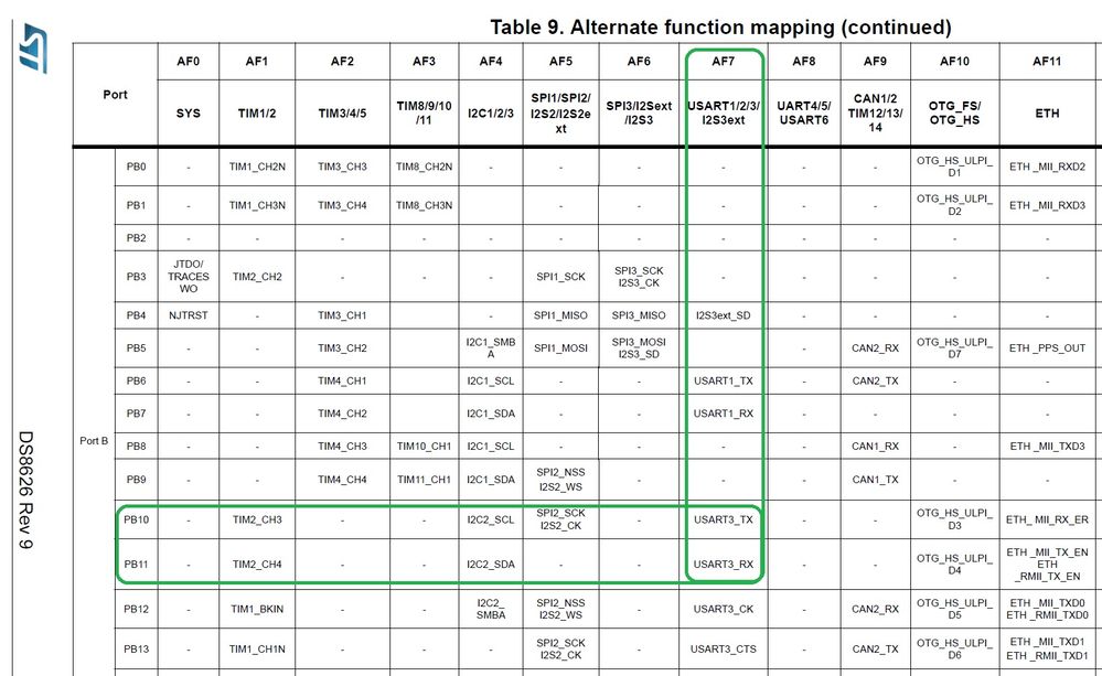

Need to understand USART3 GPIOB programming.
  • October 12, 2020
  • 651 views
I need to understand the procedure to program Port B (PB10/PB11) on GPIOB port to USART3 (UART3).
I don't understand the RM0090 manual in chapter 8.4.1 nor TABLE 39.

The DATA SHEET is the thing to look for with respect to pin mapping.
There is a 4-bit mux on each pin that selects 1 of 16 alternate-function connectivity options, the peripheral controls the pin when in AF mode
Not all 16 AF connections are always implemented, but the subset provides all the options for a specific pin.
Table 39 describes the reset defaults for the pins/GPIO registers, because it is more complicated than simply zeroing the registers.
You need to put the PB10/PB11 in PP AF MODE, and then set the AFR for each pin to AF7
https://www.st.com/resource/en/datasheet/dm00037051.pdf

Thanks. I believe I got it :)
So setting PB10/PB11 to AF7 requires the folloing steps:
GPIOB_BASE = 0x40020400
Offset of GPIOB_MODER_OFFSET = 0x00
Address of GPIOB_MODER = GPIOB_BASE +GPIOB_OFFSET
PB10 + PB11 must be set to AFMode (10: Alternate function mode)
Resulting word to write:
0000 0000 1010 0000 0000 0000 0000 0000
=>hex 0x00 A0 00 00
and
AFRH = 0x00007700
Is this correct?
