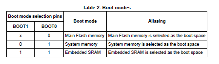

ONadr.1
Senior III
Is the bootloader enabled? In that case, some unstable signal to the UART (from uppowered card) could be causing the described behavior.
_legacyfs_online_stmicro_images_0693W00000blDtVQAU.pngAccording to this list (RM0090), I am using Main Flash Memory configuration, which I believe means that I do not use any specific bootloader. I did not also write any code for bootloader.
I also slightly believe that I do not use any combinations that is in the bootloader activation patterns (at least I believe) (AN2606).
Do you think that using high speed PLLCLK (SYSCLK 168 MHz) may result in this kind of behaviour ?
I am using the maximum frequencies that is allowed to be used. I will update here when I have the opportunity to try this.
