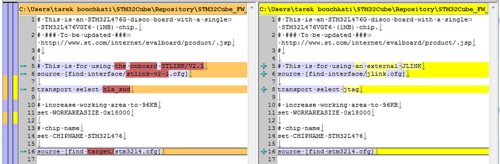

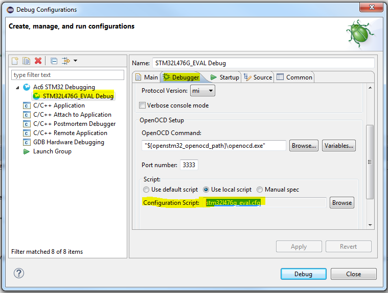

Since openocd supports natively jlink so this is possible using System WorkbenchThis is kind of tricky but possible :)For guidance I will use STM32L476G-EVAL: 1- since you cannot select JLINK from SW inteface, you need to use a cutomized script I will base on default board configuration file ''stm32l476g_eval.cfg'' located in ''C:\Ac6\SystemWorkbench\plugins\fr.ac6.mcu.debug_latest\resources\openocd\scripts\st_board'' copy this file to your workpspace and modify it as followingadapter_khz xxx
>>adapter_khz 240
then from System Workbench > Debug Configurations, select the modified ''stm32l476g_eval.cfg'' as local script''Error: Cannot find jlink Interface! Please check connection and permissions''

First of all, I am using STM32F407VTG6. So I copied thestm32f4discovery.cfg file to my workspace and modiefied lines:# This is an STM32F4 discovery board with a single STM32F407VGT6 chip.
# http://www.st.com/internet/evalboard/product/2524jsp source [find interface/jlink.cfg] source [find target/jlink.cfg] # use hardware reset, connect under reset reset_config srst_only srst_nogate I also copied filestm32f4x.cfg to my workspace and first didnt change the speed to 240 khz, but after it failed I changed it but it didnt help. I changed the script in debug configuration in eclipse and tried to debug, I got error message:Error in final launch sequence

I am using this local script in debug config for stm32f407vtg:# This is an STM32F4 discovery board with a single STM32F407VGT6 chip.
Is it correct?
