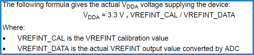

In our application, operating voltage of MCU is 3.3V (VDD=VDDA=3.3V). In firmware, we want to use VREFINT of ADC to calculate the VDDA to detect it.
According to the reference manual
, section 15.3.32 (Monitoring the internal voltage reference) at page 353/1080 described how to calculate VDDA with VREFINT. Here is the formula,Under normal operation, there is no problem. The calculated value of VDDA is right, and the value is about 3.29V which is almost equal to the actual power supply voltage.
But as long as the input voltage of PA0 (TTa, this port is used as ADC function, channel is ADC1_IN1) is subjected to a voltage greater than 3.65V, such as 3.75V, the calculated value of VDDA will be abnormal and become to about 1.22V. My question are,

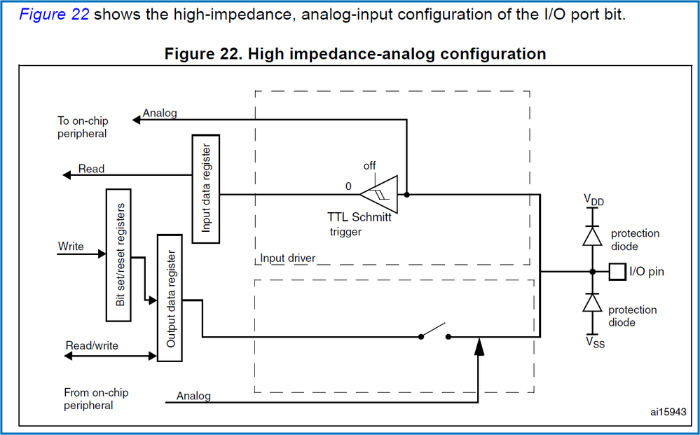

here is the internal block diagram of IO port when ADC function is used. I don't know if the 3.75V is enough to make the protection diode work. but it is not important, because from the test result, as long as the ADC port is input a voltage greater than 3.66V, the calculated value of VDDA will become abnormal, regardless of whether the clamp diode working.

1), first, I don't know if the diode can be conducted because of I don't know the Vf of the protection diode.
2), second, even the diode is conducting, why the VDDA is lifted? from the test result, we found the actual VDDA (observed by an oscilloscope and a multi-meter) has not changed at all (always is 3.3V) when the calculated value of the VDDA is abnormal (only is 1.22V).
3), use external diode with lower Vf (such as shottky diode), it is a good idea, but it is a protection method. in this topic, I still really want to know why this phenomena happened. in addition, for your suggestion of diode, we also tried before, and we found an interesting thing is that the lower Vf of diode you use, the higher leakage current of the diode. this also will cause some other issues, such as zero drift.

the VDDA rail inside the processor must be affected, anyhow you can see the result.
Stop the high voltage before it gets to the chip. <- this is your work, don't put water in the fuel tank, its a rule too.
I use the ESD protection diodes, 2 diodes in one, and works for any pin. Something like this one.;
normally you would use a resistor, maybe 100R before the diodes to protect the high current into the new diodes.
