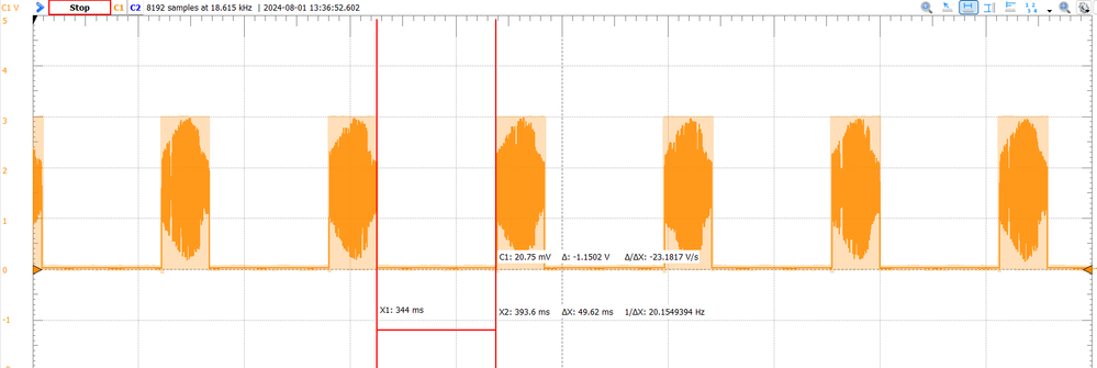

I'm relativ new in working with Nucleo Boards and currently working on a Project where i want to generate a chirp signal/sinus sweep from -20kHz up to 20kHz.I made myself the following table in excel to have all the values.

With a Clock Frequency of 100MHz, a Prescaler of 17-1 and a Counter Period of 100-1 i got a pulse length of ~20ms which is exactly what i need. The next step i want to achieve is a 80ms pause between each pulse. No matter what i write into the HAL_delay() the pause inbetween pulses wont change. Even without the HAL_delay it is ~50ms.
can anyone explain me what im doing wrong, or even gives me a hint, how to achieve this much easier?
Like i said in the beginning im new with Nucleos and also couldnt find any helpful information about sweeps in the internet.
Thanks
> I've tried to extend the pause with a delay, but it wont change anything.
Because it's in circular mode. It never stops. Don't use circular mode if you want a delay between pulses, as stated in my last post.
Your HAL_Delay function only executes once. HAL_DAC_Start_DMA only gets called once. Is that what you want? Change it to normal mode, move both of these functions to within the main loop.

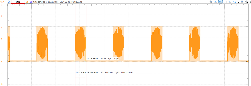

A few things:
  • DAC array should probably be uint16_t, not uint32_t, and with DMA set up as half-word width. Just wasting space otherwise, if it even works. Make the array const so it stays in FLASH. no need to dedicate RAM for a static array.
  • Are you triggering the DAC with a timer TRGO signal? You don't say or show it, but seems like you are.
  • Is DMA set to circular? Seems like it is, in which case the signal will repeat infinitely. It should be set to normal if you want to pause after each burst. Set the last value in the array to the value you want the DAC at during this delay.
Not sure your math works out.
100 MHz / 17 / 100 / 4096 = 14.3 Hz which is a period of 70 ms, not 20 ms.
Showing the full code would help.
Yes its on circular. And if you add the pause between the signals up you have 20ms for signal, 50ms pause adds up to 70ms period. Currently i have no clue where the pause comes from. Which is also the reason why i made this post. I've tried to extend the pause with a delay, but it wont change anything.
