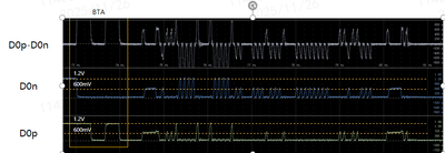

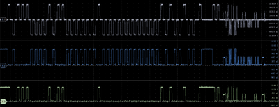

I'm trying to read the ID of ST7701SN with STM32F469. The read command was sent correctly by the MCU. But the voltage of the response by the ST7701SN is too low. Could it be caused by the settings of the MCU? I tried different screens but it's always the same result.
