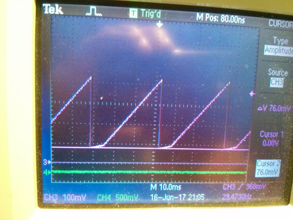

What is the minimal voltage the DAC can output?
When I read the Datasheet for the stm32f301 I can see a min of 0.2V with buffer ON.
However when the buffer is OFF the manual says 0.5mV.
I use the DAC internally as input for the comparator. When I set the DAC to 0x0000 I can read ~50mV on the output pin.
If I plot a linear ramp I get the first beginning from 50mV up to ~150mV very slow rising and then from there to VCC with the normal and linear slope.
Why is that? Why does the DAC only give me a minimum voltage of 50mV and not 0mV? Why is the first part of the ramp with a different slope?
I tested a stm32f301 on my custom PCB and also the STM32F303 on the stm32f3 discovery.
Any hints?

2017-06-17 10:24 AM
The '200mV MAX' from the datasheet translates to 50-150mV in practice.... Sounds familiar. This is a restriction from the buffer opamp inside the chip, not from the DAC itself. When I measured this effect, the result was very similar near the top end of the range.

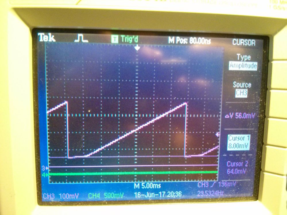

2017-06-17 12:24 PM
Thanks for your posts. I re-did my measurements.
I wrote a minimal code example which is only doing DAC init now.
And indeed, when the buffer is switched off (properly) the DAC gives me zero volts on the eval board:
With the DAC amp on:
So this makes all sense to me now.

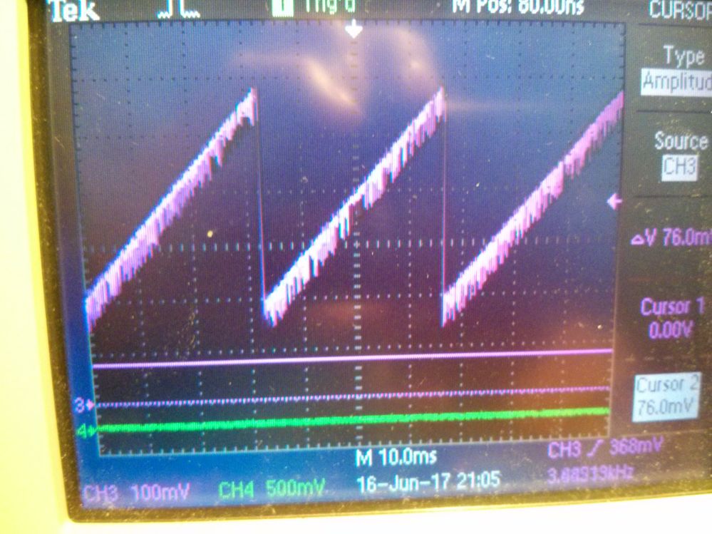

However doing the same on my custom board with an stm32f301 gives me this on AMP off condition:
Looks quite strange, a lot of noise and the whole ramp is shifted 150mV?!

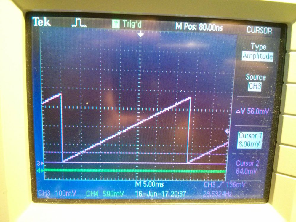

When I switch the amp on i get the pattern I am used to:
Any Ideas what might cause this problem?

2017-06-18 4:22 AM
The output swing increases with buffer amp off, but the output impedance goes way off, about 1 MOhm.
If you really want to use the internal DAC, design your own buffer amplifier.
BTW, this quirk of ST's DAC implementation persists since the very first STM32.
Read the datasheet <very> carefully...
2017-06-18 5:23 AM
The output impedance of the DAC is very high. So on your development board it seems as if some high frequency signal is coupling to the wire connected to the DAC.
We could assume the DAC to have a 1M Ohm output impedance, and that the 'high frequency signal' is 3V top-top, Then we can measure the noise to be 50mV and we can deduce the impedance of the coupling to be around 66MOhm. This could be some dirt left over from soldering or maybe you haven't shielded your high speed signals properly. A picture is worth 1000 words....
Edit: I just noticed the 150mV shift... So you're injecting close to 150nA of DC current too....
