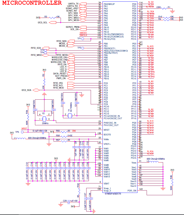

Posted on May 16, 2017 at 07:15
Hi Clive,
I have found out couple of differences between my custom board schematic and stm32f429zi disco. And PFA of my custom board schematic.0690X000006071AQAQ.png0690X000006071FQAQ.png
They are as follows. Disco board schematic
http://www.st.com/en/evaluation-tools/32f429idiscovery.html
  •      STM32 Disco board doesn?t have resistors at pin PH0-PH1(8MHz oscillator in and out) which our board has.
  •      Disco doesn?t have 33.2KHz crystal (LSE) crystal fitted on board but our board has.
  •      NRST is being pulled to 3.3v in custom board with 100k and 0.1uf which disco doesn?t.
  •      PDR_ON pin on or board is pulled to 3.3v via 100k.

Posted on May 16, 2017 at 18:24
The DISCO however uses an 8 MHz crystal/clock-source, so different code and PLL settings WILL be required.
You should enable the HSE and feed it out via the MCO (PA8) pin and verify the clock from there. The PLL_M setting will need to changed from 8 to 25 to get the correct 1MHz comparison frequency into the PLL.
You've indicated you've done this, but the 'same code' argument falls over here unless you modify the DISCO board with your oscillator design, and disconnect the 8 MHz source. I would tend to do some very simple test code when bring up the board, and instrument that via a serial port to pin down where in the SystemInit() or PLL/Clocking code things were going awry.
