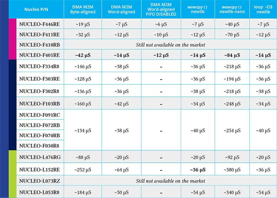

For example, the newlib library provides a speed optimized version of memcpy(), which automatically detects word-aligned memory transfers. The newlib-nano memcpy(), being optimized for size, it doesn't perform this type of check. Moreover, you should also try DMA m2m transfers word-aligned: for some STM32 MCU you can achieve more than 4x speed-up.
These are some test results I've obtained on a wide range of STM32 microcontrollers:

Simplyfying the table, we toss out the ''byte aligned DMA''. We're not interested in that and performance is bad anyway. The same we do for the ''newlib-nano'' memcpy: It has bad performance. And the Loop is exactly the same as ''newlib'', so that one goes out as well. That leaves DMA(aligned DMA) vs newlib (software copy). In many cases the result is about the same, except for the L152 where DMA is a lot slower.
So, IF you can have the CPU doing something else, doing it with DMA is faster, otherwise, doing it in software can be about as fast as DMA can achieve.
Doing something else with the CPU is difficult: Chances are that the CPU will need the memory bus. So if you manage to get the CPU to do ten things, it will hold up the DMA transfer for ten extra cycles. So even if you get something done while the DMA runs, the total running time may not be less than if you did the memcpy in sofware and THEN did those ten things.
Something can be said for simplicity: Just do it in software.
