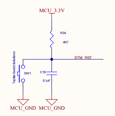

We are using the STM32 MCU (Part No. STM32F407VET6) on our custom board, and we are currently facing an issue related to the reset function.
During board power-on or after program loading, the MCU appears to enter a hold or non-responsive state. This issue occurs every time the board is powered OFF and then powered ON. However, when the hardware reset button is pressed, the MCU starts functioning as expected.
We kindly request your support in identifying the root cause of this issue. Please advise if any modifications are required on the firmware or hardware side to resolve this behaviour.

> As @mansi suggested, try a reset controller - or just manually hold NRST low during power-up.
That can be done by a simple RC element on the reset input, a cap to GND and a pull-up resistor.
Until the cap is charged up H level threshold through the pull-up at power up, this will hold the MCU in reset.
I have seen this simple trick in many designs, by the way.
The schematic does already have that.
The suggestion is to try it to see if it makes any difference

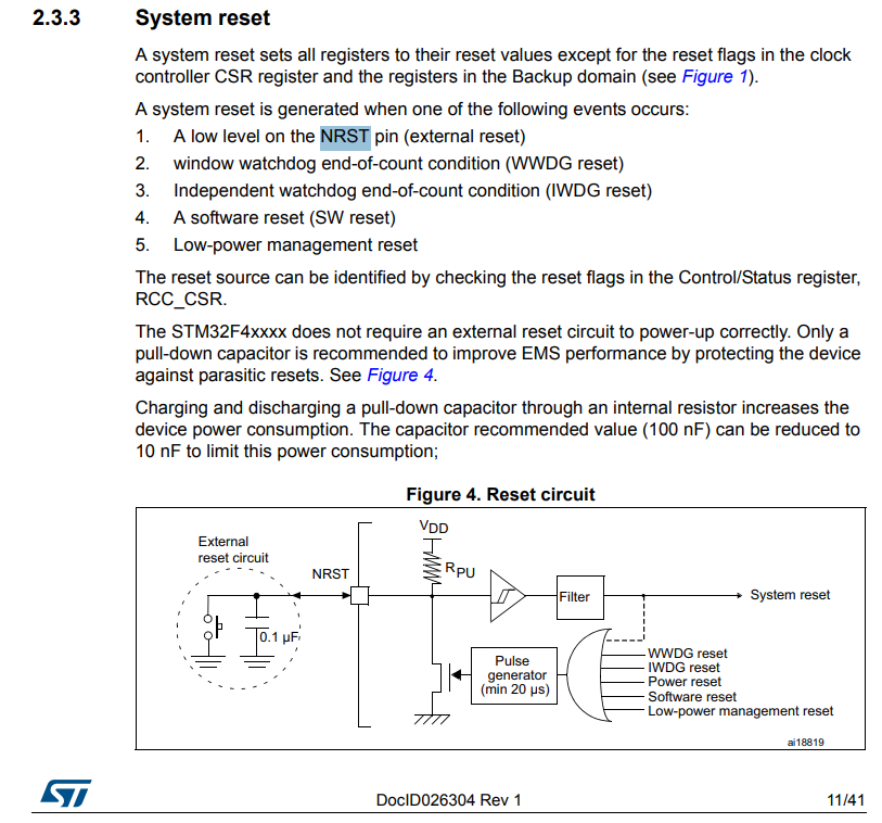

From the posted schematic:
From the STM32F4 Hardware Design Guide:
http://nic.vajn.icu/PDF/STMicro/ARM/STM32F4/STM32F4xx_Hardware_Dev.pdf#page=11
Which recommends no external pullup.

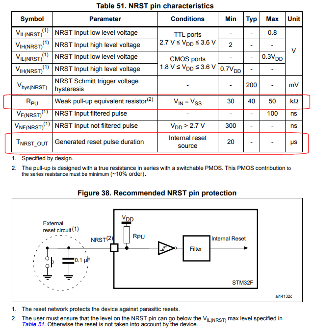

This is repeated in the datasheet:
https://www.st.com/resource/en/datasheet/stm32f407ve.pdf#page=120
Although an external pullup is generally not considered harmful, the 4k7 shown seems a bit low - so maybe it's giving a too-short pulse ... ?

Of course, different architectures have different requirements - the STM32 docs are ST's specific recommendation for the STM32.
Again, it's not required for the STM32 but also generally not considered harmful - lots of people do, indeed, do it.
But the STM32 documentation recommends 0.1uf with just the ~40k internal pullup - so adding an external pullup of just 4k7 could well give a too-short reset pulse...
