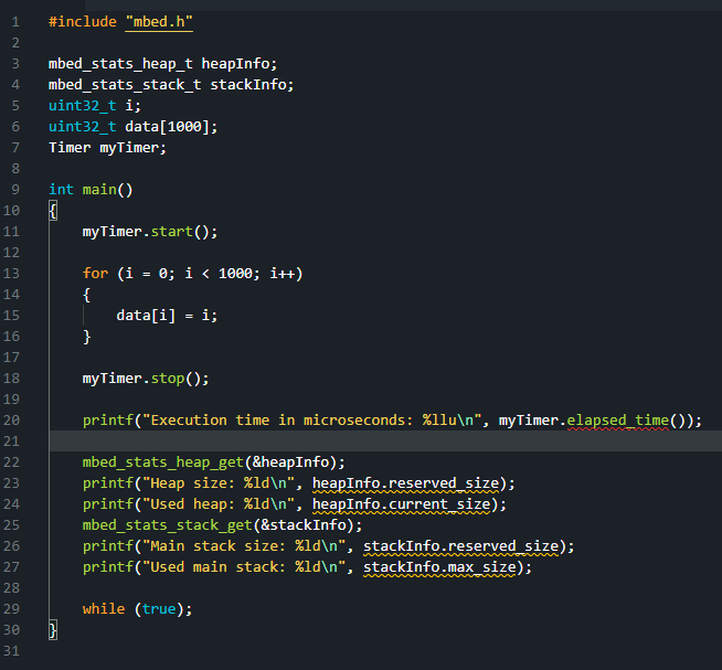

Following code has squiggly under bars in printf statements:
Is there a simple way fix these compile errors please:
This program is from Embedded System Design with Arm Cortex-M by Cem Unsalan et al,
chapter 3 page 50.

What exactly does it report as an error/warning ?
That the printf format doesn't match the type of the variable you're trying to print ? try fixing that

printf("....%ld\n", (long)size);
Is this simple enough?
