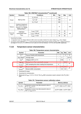

I am able to read the mcu temperature but I want to know the maximum worst-case time required to read the internal temperature of stm32h743.

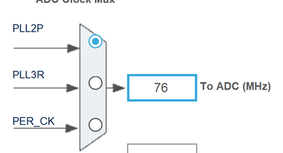

The clock for the ADC is configured as 76 MHZ. Does that mean that 1 ADC cycle is 0.013 uS (1/76M) ?

The datasheet says that the minimum sampling time should be greater than the stabilization time, but I am not bale to find the stabilization time. Could you please tell me the minimum sampling time I should set to read reliable temperature values ?

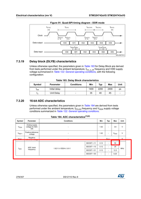

No, there's an additional prescaler, ADCx_CCR.PRESC. You should not set it so that ADC clock is 76MHz as maximum ADC clock is 50MHz (with appropriately set BOOST bits -- in rev.Y the max. ADC clock is lower).

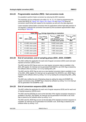

That's unfortunately misleading and valid only if you select 14-bit conversions. The conversion time depends on selected resolution (and also if the sampling time was selected the shortest 1.5cycle or not):

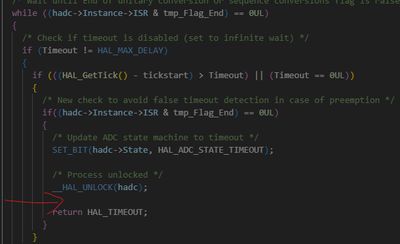

Cube/HAL is open source, so you can track what could cause the error, and also in case of the error observe the ADC registers (especially status register) to gain more insight.
Hi @waclawek.jan , Thank you for your reply.
Yes, The error code returned is 0x03 which is HAL_TIMEOUT.
This is returned from the point marked below and the value of ISR and ADC3_CSR is same which is 0x1003.
This means that the EOC flag is not set.

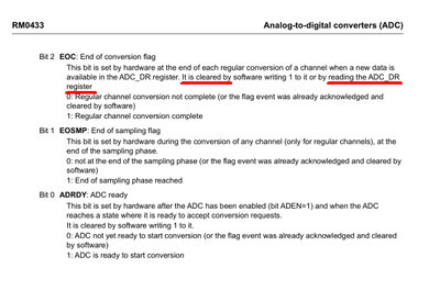

However, while *timing* may not be affected significantly, reading registers through the debugger does have consequences: in your case, reading ADC registers, namely ADC_DR, using the debugger, clears the EOC bit:

Hmm..I see your point and I understand why I am seeing this during debugging.
