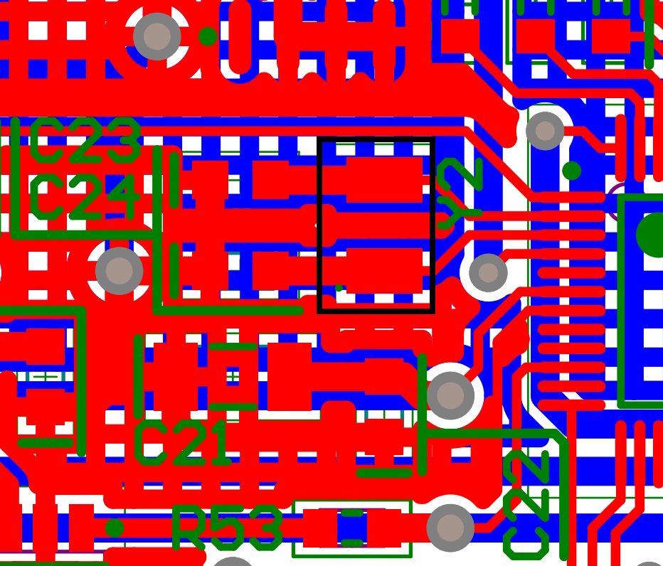

I had use VBat with external low frequency OSC for RTC which it's can run fine even reset has occurred.
But it's has problem when it was boot from power off with VBat.
it's going to TimeOut error while checking LSE state in RCC initial.
/* Check the LSE State */
if (RCC_OscInitStruct->LSEState != RCC_LSE_OFF)
/* Get Start Tick*/
tickstart = HAL_GetTick();
/* Wait till LSE is ready */
while (READ_BIT(RCC->BDCR, RCC_BDCR_LSERDY) == 0U)
if ((HAL_GetTick() - tickstart) > RCC_LSE_TIMEOUT_VALUE)
return HAL_TIMEOUT;
}the RCC_OscInitStruct->LSEState is set so it go to waiting RCC_BDCR_LSERDY was set but RCC_BDCR_LSERDY is not set even I try to extent RCC_LSE_TIMEOUT_VALUE, it's not matter.
only way I can do is power off it and remove a battery for a while.
And add a battery again then I take power on for it.
the system clock will go fine again.
I have no idea why LSE clock boot fail in VBat Mode but It boot fine without VBat Mode
this is my RCC config which it has nothing special.
the Error is in HAL_RCC_OscConfig(&RCC_OscInitStruct), that 's too early.

2023-05-10 12:51 PM
If the LSE is running, with a crystal, at the point where you shut down the main power then the LSE should continue to run as long as VBAT provides power. What kind of battery is connected to VBAT?
If LSERDY is not set after restarting, then the RTC and VBAT have failed in some manner. You should not have to wait for LSERDY if the LSE continued to run from VBAT. Assuming the RTC and LSE work correctly with main power then the problem may be with the type of battery or how it is connected to VBAT.
If you have an oscilloscope, you can verify the LSE is running by checking the LSE pins on the STM32 while main power is off. You should see a 32.768KHz waveform. If not, you have a hardware problem (unless you turn off the LSE as part of a shutdown procedure). What voltage do you see on VBAT with main power off?
Jack Peacock
2023-05-11 2:51 AM
I had use CR2032 for VBat
2023-05-11 5:23 AM - edited 2023-11-20 5:51 AM
I think that it maybe about PCB Layout but it just maybe, I'm not sure that I need to prove it by check OSC signal with Oscilloscope later.
But I don't think a LSE design guide is very strict that I think it should be good enough to operate.
and I had check a power supply that it work fine.
I have to find out what is the root-cause.

2023-05-16 8:41 AM
Hello @Tinnagit,
Could you explain what solved your problem? so it can be benefic for other users facing similar issue
Thank you!
2023-05-16 8:50 AM
Ok, it's too complicate.
I had 5 boards and it's only single one it can solved by cleaning a PCB by solvent.
And the other board, they are not work fine.
So I think that I have to re-design this board with very restrict to follow AN2867
Oscillator design guide for STM8AF/AL/S, STM32 MCUs and MPUs - Application note
And if it's work fine that I will update later.
2023-07-23 11:01 PM - edited 2023-07-23 11:11 PM
After that... I had check that it's about LSE Clock Source.
so I had don't use LSE Clock Security System (CSS) - Disable CSS in CubeMX Clock configuration.
(don't have this line in RCC)
HAL_RCC_EnableLSECSS();
and it can boot fine. this problem is gone.
a necessary stuff to program the firmware to controller please remove Battery backup before start program it and attach it after testing that it can boot fine.
