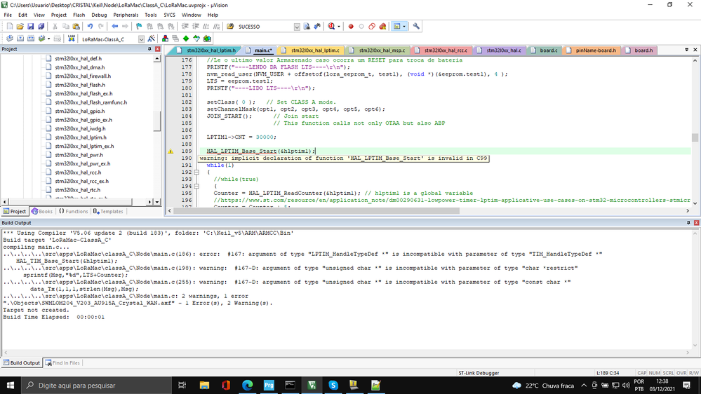

I am using the low power timer (LPTIM), but i need to initialize the timer value to 30000 before start the counting.
Is it possible ?
Thank you!

Yes:
LPTIM1->CNT = 30000;
You can do this prior to using HAL_TIM_Base_Start() HAL_LPTIM_*_Start if you're using HAL since the function doesn't touch the counter.

I had done
But, i hadnt used the HAL_TIM_Base_Start()!
I will try then tomorrow this sequence!
HAL_TIM_Base_Start(&s_TimerInstance);
Can i always repete this sequence in at any point in the program and repeat it ?
Because i will receive a LoRaWAN message that contains this LPTIM1 value.
I will have to change the LPTIM1 many times
Thanks

Did you see that is not writable the lptim counter ?

can you send a example setting the LPTIM1 counter value ?

You need to use HAL_LPTIM_* functions to interface with LPTIM timers, not HAL_TIM_* as I wrote previously.
Good luck.
Hi, i had tried that but got compiler error!
