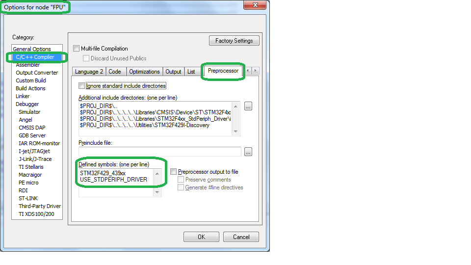

Add the preprocessor macro ''USE_STDPERIPH_DRIVER'' to your project settings, this should solve the problem. Not sure how to do this in the IAR WB. In a Makefile-based project, one would append ''-DUSE_STDPERIPH_DRIVER'' to the CFLAGS.
If you want to know why, look how this macro is used in stm32f4xx.h.

Here the defines used for the STM32F429I-DISCO, I prepared the art so posting it all the same.
0690X000006054XQAQ.pngI'm not sure it matters if you defined the function or not, it's in one of the project files, shares the same name space, and clashes with yours. So you'll either have to use a different name if it's a different function, or pick which of the instances or files you want to use.

hi i have given the paths as shown but still i'm getting this error ,  please help me to solve this
Error[Pe020]: identifier ''GPIO_Pin_12'' is undefined D:\Ramya\STM32F4\STM32F4_Discovery Kit\STM32F4-Discovery-Firmware-master\STM32F4-Discovery-Firmware-master\Utilities\STM32F4-Discovery\stm32f4_discovery.c 69

Have you added the define ''USE_STD_PERIPH_DRIVER'' to your project ?
