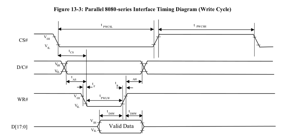

Below is the Write Waveform from the SSD Datasheet (Pg. 83):

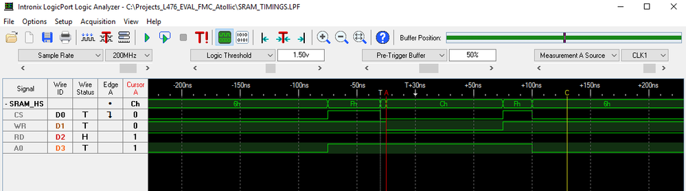

Here is what I get from my logic Analyzer from the Eval Board (Note:  A0 drives the D/C# line and the Data Lines are not shown because I can't find an access to them even on the Eval Board)  CS is driven by NE3/NE1:

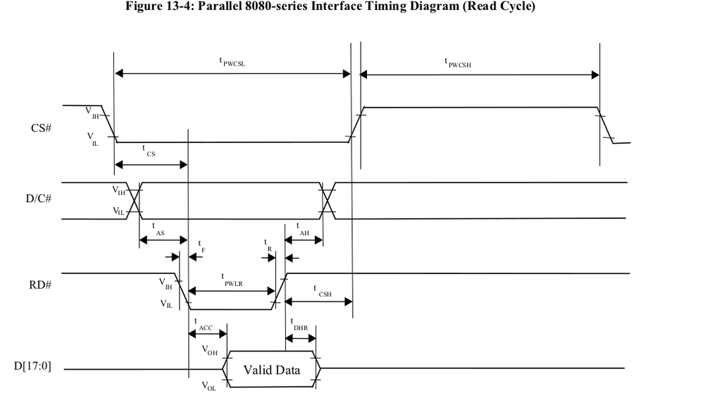

Below is the SSD1963 Read Timing Diagram from the SSD1963 Spec (Pg. 84):
And Here is what the Read Cycle on the Eval Board's FMC looks like on my Logic Analyzer: 0690X00000606cUQAQ.png  Please note that I am running the FSMC/FMC in SRAM Mode-B operation
(Mode B seems to match the closest to the SSD1963 waveforms according to CubeMX). Please Let Me Know what other documentation you need from us....

I have gotten the SSD1963 interfaced display working, but I had to make the CS pin like a permanent GPIO ground, instead of letting it being controlled by the FMC.  If I let the FMC control the CS, then the display misses some of the read/write transactions to it which affect what is put on the display, and the LCD setup.  My guess is that the CS timing is too tight for the LCD Display.
Is there a way to even adjust the CS timing relative to the Read/Write timing transactions?  I haven't seen anything that says this can be done.  I need the CS to go low about 4 HCLKs before the Address Bit is put on the bus, and have it stay low until after the trailing edge of the RD or WR signal.

You've posted the same picture twice.
You did not post the content of relevant FSMC registers.
In the 'L476 there's no FMC according to my copy of RM0351.
According to UM1855, some of the data lines are brough out to RM6/RM7. Btw, how did you connect the  display physically?
There's also something terribly wrong: the write pulse should end (rising edge) one HCLK before CS (rising edge). What's the HCLK frequency?
Also the fact that CS goes low soon after that write is suspicious, I see no reason for that.
Set the analyzer to 500MHz otherwise the granularity of 5ns at 200MHz might cause some edges to appear to overlap.
