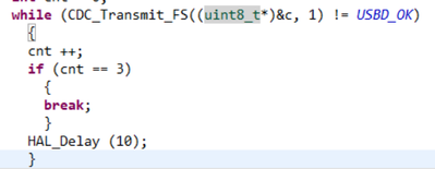

In first CDC_Transmit_FS(), watchdog timer is expired.
Because, I call  while (CDC_Transmit_FS((uint8_t*)&c, 1) != USBD_OK); to ensure tx opeation thru USB is completly before next tx.
At this line, watchdog is working. It looks not working my board.
Temporary, I modify this line and test like this.
And go next step.
When USB cable is disconnect on the go or USB cable is not connected at reboot time, CDC_Transmit_FS((uint8_t*)&c, 1) return FAIL.
