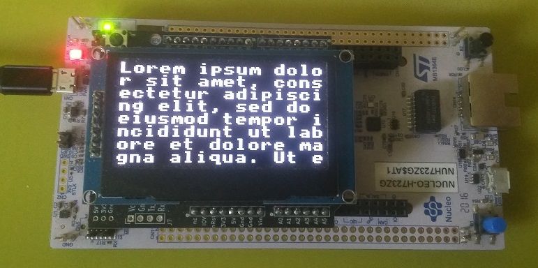

I want to know if there are other platforms like proteus in which I can virtually simulate STM32 MCU and OLED display.
STM32 programs are not working in proteus. I just used simple toggle LED program but it is not running on proteus,

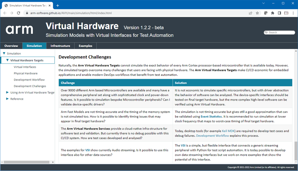

    Pavel A.
    June 6, 2022
    Recently ARM advertised their "virtual hardware". Maybe, this.
    Andrew Neil
    June 6, 2022
    Interesting - although still not a complete, timing-accurate simulation of a specific microcontroller:
    0693W00000NrHlbQAF.pnghttps://arm-software.github.io/AVH/main/simulation/html/index.html#Development_Challanges
