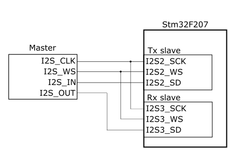

Is there a way to use I2S Full-duplex with the STM32F207 as slave?

Yes. Set one of the I2Sx/I2SxExt couple as Slave Receiver and the other as Slave Transmitter.

Thank you for your reply!
I'll have to connect I2Sx_WS and I2Sx_SCK on the same master signal?
What do you mean by "same master signal"?
Post a diagram/sketch.
TapiTapo
Here a draft sketch.
The I2S master clock and word select going to both I2S slave interface.
Yes, that's it.
