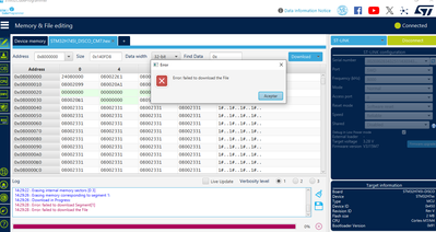

after completing the deletion without problem but being still connected, the 3.3v was disconnected by mistake and now even if I remove boot0 from the 3.3v and reboot the board when loading the code, it indicates the following error
from the stm32cubeide I could load the code but when debugging the same thing happens it stays in invalidate D-cache I do not know what I can be doing wrong are a few steps with the stmprogrammer
Forget about your application for now and after recovering the MCU with the steps discribed previously, try to load an existing application with any example provided in STM32CubeH7 (Example: https://github.com/STMicroelectronics/STM32CubeH7/tree/master/Projects/STM32H745I-DISCO). If it doens't work, I'm afraid it could be something related to the chip itself and something gone wrong (corrupted flash, or broken chip ...) and I cannot have more to add.
