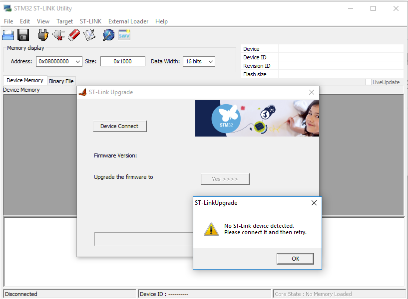

My computer OS is Win10, 64bit .For STM32 ST-LINK it won't able to connect with STEVAL-IDI002V2(STM32L1) Device and also in device manager STEVAL-IDI002V2(STM32L1) Device did not recognize.But stm32nucleo board successfully detected and showed in device manager.
This is the output image of STM32 ST-LINK when IDI002V2(STM32L1) Device going to connect.

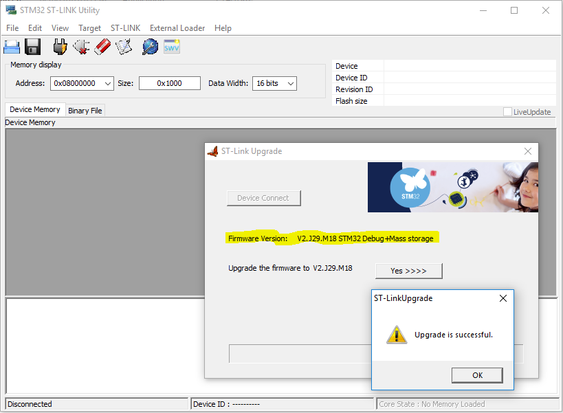

This is the output image of STM32 ST-LINK when stm32nucleo Device going to connect.

I don't think this board embeds an STLink.
You need to use an external tool to program its MCU​.
I have luckily programmed with STM32 ST-LINK Utility with STEVAL_IDI002V2.hex (en.stsw-idifw_firmware package) but bigger problem comes up when connected together with IDI003V2, RED LED GOES DOWN and ST Link goes down.
