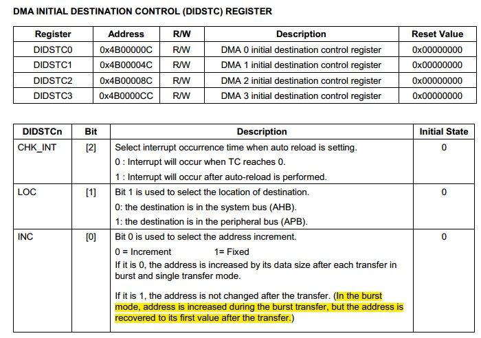

In burst mode, when the destination address is set to fixed, STM32F7 chip can increase the address? Because i see the Samsung chip can do this:
So want to confirm the above content, thanks.
