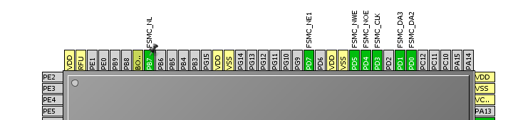

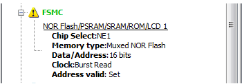

I am trying to configure STM32F207ZG nucleo board for synchronous muxed NOR flash and have configured for the same over cubeMX
after generating the code i am calling HAL_NOR_Program and HAL_NOR_ReadBuffer in my code.
I probed FSMC_Clk signal but no trace of it on DSO.

What about your initialization code and configuration?
Please share your .ioc file to check if you have correctly configured your project.

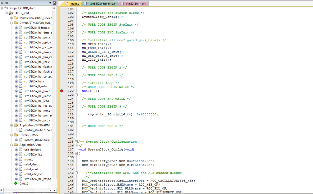

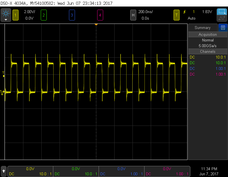

Your project worked great and FSMC_Clk signalappears for me.
Based on your configuration for
, I just added read access in the While loop to the
BANK1
with address 0x60000000. Then the
FSMC_Clk
signal appears.
/* USER CODE BEGIN WHILE */
while (1)
/* USER CODE END WHILE */
/* USER CODE BEGIN 3 */
tmp = *(__IO uint16_t*) (0x60000000);
/* USER CODE END 3 */
Regards
Imen
Thanks
Imen
Posted on June 08, 2017 at 09:15
Thanks
DAHMEN.IMEN
I was callingHAL_NOR_ReadBufferto read in while loop ,the problem was with the address which I was using for read cycle. I was sending the address as 0x00000000, then I changed it to 0x60000000 as you said ,now I am able to see FSMC_CLK on LA.

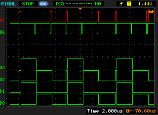

For the same configuration(sync muxed NOR) I checked for write operation by runningHAL_NOR_Program()in while loop.
uint32_t addr= 0x60000000;
uint16_t data=0xEEEE;
while(1)
(HAL_NOR_Program(&hnor1,&addr, &data);
Then I probed AD[3:0] ,NOE ,NWE to check program but what I am getting is unexpected -0690X00000602UHQAY.bmp
D7:- NWE
D6:- NL
D[0:3]:- AD[0:3]
here data(0xEEEE) is not as I am sending (for
AD[0:3] it should be E
but getting something different as output.
