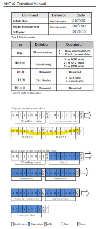

From my research, it seems the AHT10 sensor is on address 0x38. I have attached from what I think is the datasheet for the AHT10 as well as a couple pictures of my setup as well as my .ioc file.

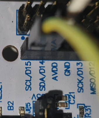

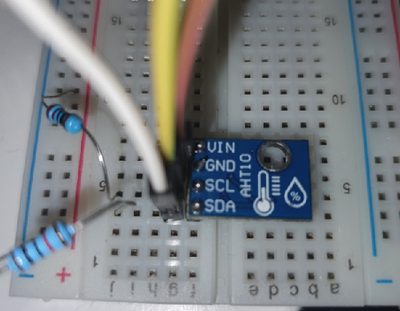

My AHT10 sensor with the 2 pull up resistors (both connected to positive rail
The 2 wires connecting back to my nucleo board.

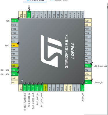

Image of my .ioc file
I have attached the AHT10 datasheet (i could be wrong but this is what i found).

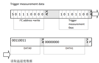

It's not very clear, but it looks like the trigger data needs to be 0x33, 0x00.
