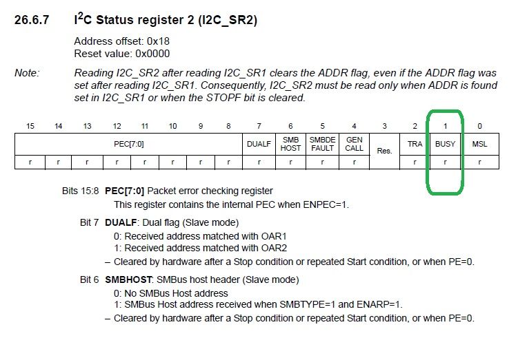

Print out I2C1->SR2

Ok, that's something I can understand. I put a little Code into my program that outputs the register every time Hal is not ok.
And interesting I have two cases of error:
In the first case the Output is wrong but not zero (something around 700) :
Error 3 = 0011 ⇾ This means busy and Master Mode
0693W000007CQKdQAO.pngIn the second case the Output stays zero:
Error 2 = 0010 → This means busy in Slave mode???
0693W000007CQKYQA4.pngSo now I'm confused...
