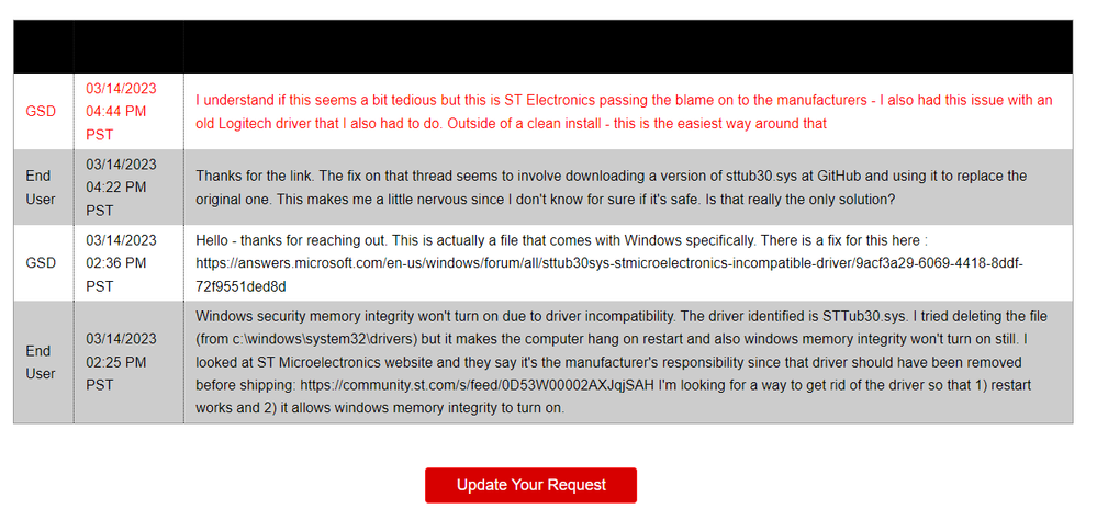

Appreciate the help here. Just wanted to show that customers are getting told by MSI that they are not to blame. This is an exchange I had with MSI. I still haven't installed the file that @Community member​ provided out of fear of making things worse but I probably will eventually since that seems like the only way to get windows memory integrity working.

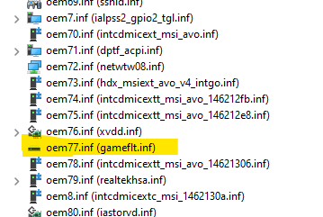

Hello. As I wrote in another thread.
All you guys have to do (in case this file isn't associated with an oemxx.inf published name) is rename (and not delete) the driver from STTub30.sys to STSTub30.sys.old and you'll be able to activate Memory Integrity. In case it's associated with an oemxx.inf published name, delete it using the device manager.
Regards.
