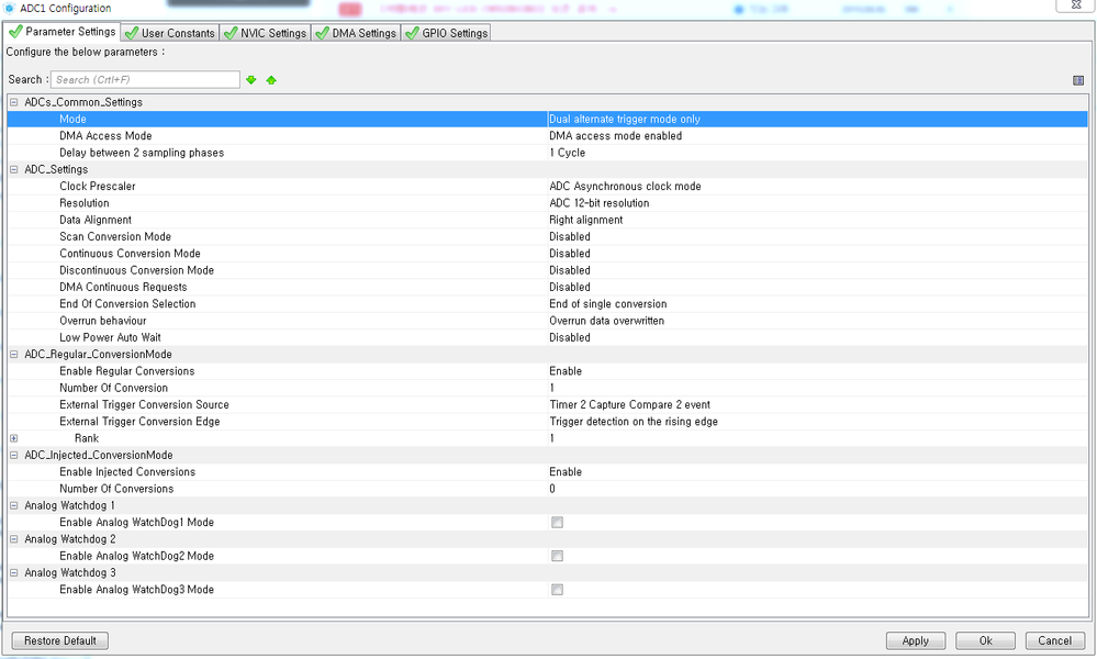

I want to convert 4 analog input in the same time, I chose the stm32f3 303vdt because it contains 4 ADCs. The problems is that I don't know how to get them working together. I have read that only two of them can work simultaneously ADC1 and ADC2, ADC3 and ADC4.
so i can use DMA setting.
My question is what's configuration have I to do for this stuff?

how can i dual adc mode?
‎2017-03-30 11:14 PM
Use them in pairs (ADC1+ADC2, ADC3+ADC4) in dual mode, then use a common external trigger (TIM) to synchronize them. I believe posted an example of doing this to the forum.
It would perhaps be useful to explain 'at the same time' in more detail.
Depending on the bandwidth of your input signal, a single ADC with multiplexed channels and a sufficiently high sampling rate might suffice.
I might be wrong, but the clearer the description of the issue, the less guessing.
