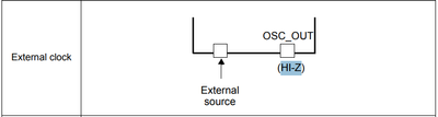

In the RM i found out that, when using HSE BYPASS mode, PH1 (OSC_OU) should be left in HI-Z state
What does HI-Z means in STM32 MCUs? does it mean configuring the pin as digital input? or it means configuring the pin as analog input?
Or it depends?

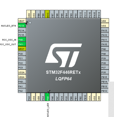

When selecting HSE BYPASS MODE the chip image in the .ioc file gets set like this:
But if i try to  set PH1 (OSC_OUT) as GPIO a conflict is generated, so, how can i set the state of PH1 as HI-Z?
Also, why does PH1 gets reserved and configured in the chip as OSC_OUT? is this to avoid configuring it as another thing?

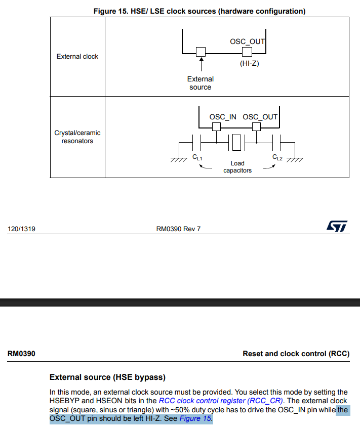

Indeed it does - here is the full context:
https://www.st.com/resource/en/reference_manual/rm0390-stm32f446xx-advanced-armbased-32bit-mcus-stmicroelectronics.pdf#page=120
@mƎALLEm Indeed, this wording is misleading: it suggests that this is something that the user has to actively do - which, as you say, is not the case.

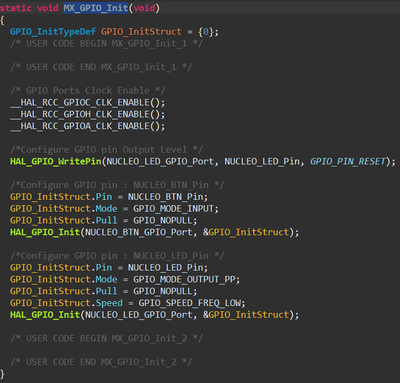

But @AScha.3 what seems weird to me is that the enabling of GPIOH clock gets done (by automatically generated CubeMX code) after clock gets configured
AScha.3
November 30, 2025
I think this is just the "standard automatic" : if a pin on port xx is used, port xx clock is enabled.
And this is basically a good idea ....dont ask me, how many hours i was fiddling around with my first arm cpu, F103,
until i found out: enabling power to port is needed, but to get any reaction from the port (= its working), the clock for this port also has to be enabled. That time no nice Cube or integrated IDE, just bare metal writing...ugly for beginner. (13 y ago...)

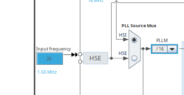

I tried: set HSE bypass; the bypass setting is used in clock tree:
And what we dont know: the internal connection of the oscillator -> maybe it can only switch it to the port, in+out, or not at all. So no use of the osc-out pin possible.
