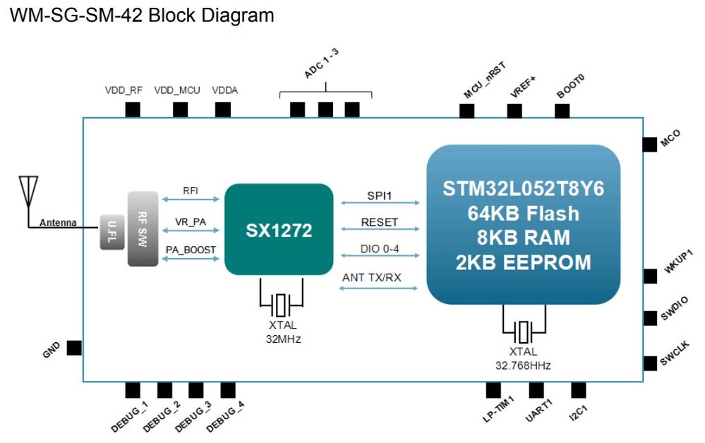

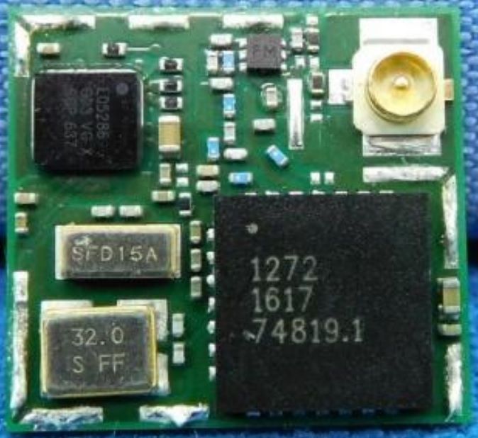

I created this quick digest from the schematic this morning. The earlier pin lists were done from the data sheets of the module and the STM32 datasheet. I had done that to see how easy the port would be, but the Murata solution had a better L0 part, and SX1276, so I focused on that.
I have since soldered an SWD header on the USI board and replaced the firmware with a port of the LRWAN tree.
By default I think most things are hooked up, the Arduino pin options tend to select one or the other.
>>Is JP8 by chance the SPI port ?
Yes
>>Is JP9 by chance DIO0/DIO1/DIO2/DIO3/DIO4/DIO5/RESET (reset for SX1272 ?)
Yes
PM me with an email address for the schematic.
