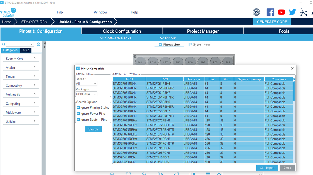

I have battery simulator solution written for STM32G071RB microcontroller and would like to know if i can use boards with STM32F4 microcontroller. I guess it depends on pin layout or similar? Thanks in advance Tomislav
TFala.1
1 REPLY 1
Javier1
Principal
You guessed right.

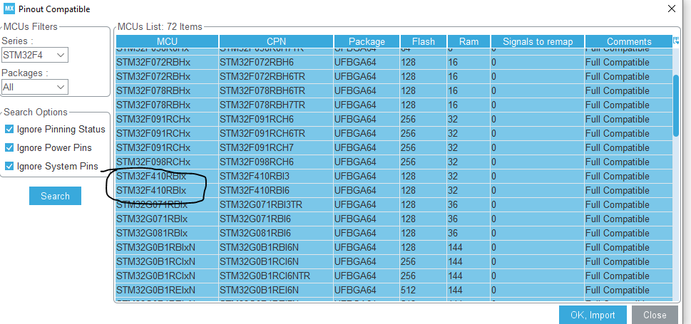

  1. download cubeMX,
  2. open a new project with your STM32G071RB(your package digit is missing) mcu, File->New
  3. press Alt+L, enjoy the list of compatible mcus.
for example: STM32G071RBIx
