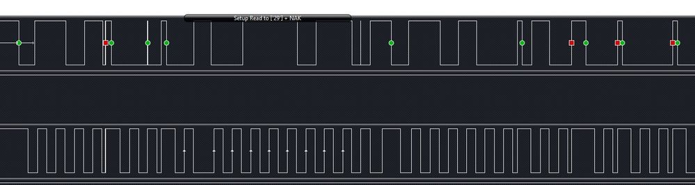

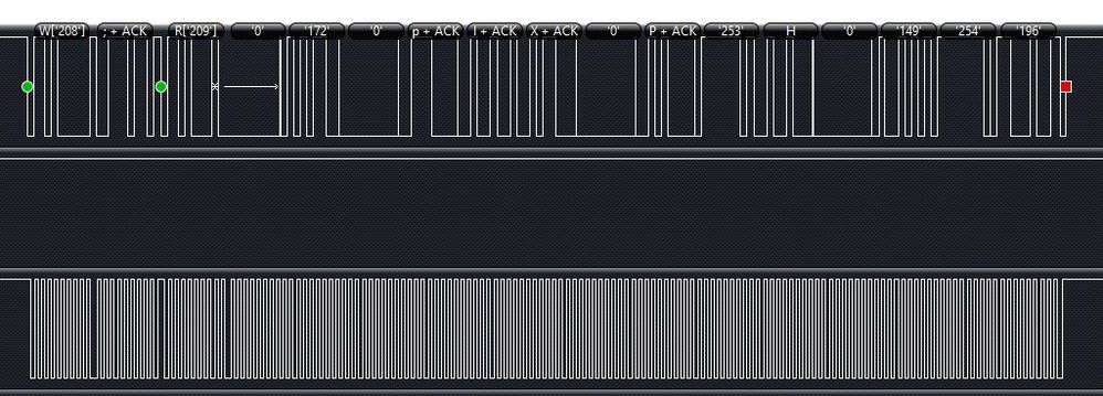

Hello
I measured I2C through logic analyzer.
The figure below shows when the I2C is operating normally.
The figure below shows I2C behaving abnormally and unable to read values.
I set the I2C frequency to 100k.
So when it's normal, the SCL works well at 100K frequency.
But when it's abnormal, I2C randomly sends out the SCL out of 50-130k instead of 100k.​
Why is the SCL sending it off at a different frequency when it has the same firmware and it simply turns it off and on? In this case, which part do I have to?
please .. help me ㅠㅠ​

Glad you were able to get a logic analyzer and see what the problem is. I don't know why the SCL line is abnormal, but I would guess there is an issue in your code.
@Community member​
The I2C is used to communicate with an acceleration sensor called MPU6050.
Logic analyzer results are separate from GPS.
