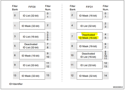

I have a question about the CAN filter numbering diagram in the RM0316 Reference manual
Ukazu
Hi
In the figure below, FIFO1 filter bank 7 and filter bank 10 have the same settings. If the ID list is 16bit, I think it is correct to have 4 Filter Nums. There are two filter banks 7, 4 and 5. Is this correct?
KDJEM.1
Hello @Ukazu ,
Thank you fringing this issue to our attention.
Figure 394. in RM0316 is wrong and should be:
Filter bank 7 and filter bank 10 haven't the same settings.
Filter bank 7: Deactivated ID Mask (16-bit), Filter Num 4, 5
Filter bank 10: Deactivated ID List (16-bit), Filter Num 8,9,10,11.
I reported this typo internally.
Internal ticket number: 166948 (This is an internal tracking number and is not accessible or usable by customers).
Thank you.
Kaouthar
