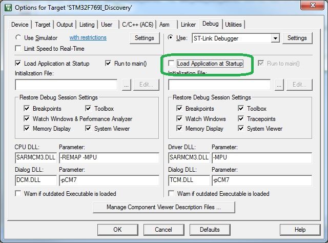

In Keil the ULINK2 should be usable, but you'd have to create/build a fake project, set options to NOT download, and then when the debugger opens you can use the SAVE command to pull out the firmware to a .HEX file.
The ST-LINK Utilities might support the STR7, not sure.
The Segger J-LINK, and assorted flashing tools, certainly should.

Thank you for your interest. I want to know more detail about how to set to options and save command in Keil.
@Peter BENSCH​ I'm touched by your kind reply. Thank you.
Experiment on something non-critical first. Uncheck "Load Application at Startup", automatically turns off "Run to main()"
0693W000008whktQAA.jpghttps://www.keil.com/support/man/docs/uv4/uv4_cm_save.htm
https://developer.arm.com/documentation/ka002842/latest
I succeeded in extracting the hex file with the method you told me.
Like that => SAVE C:\TEMP\TEST.hex 0x80000000, 0x8003FFFF
