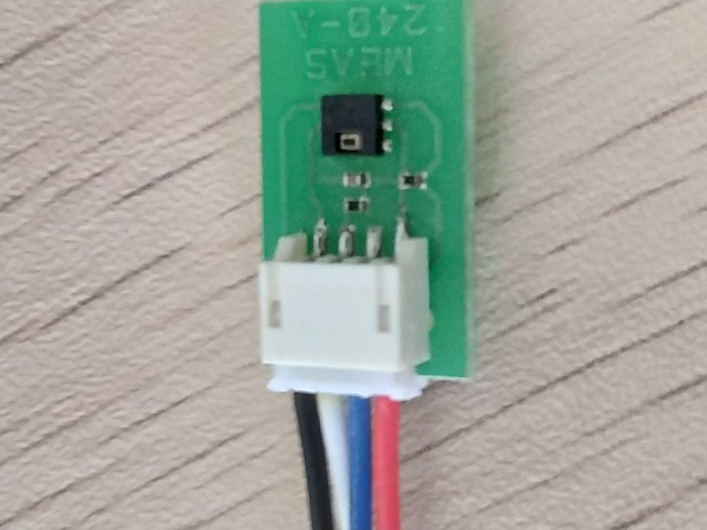

I am newbie to use Nucleo-L152RE board. I have a HTU21D-Temperature & Humidity sensor which used I2C interface to read the temperature data.
So, with using the STM32CubeMX I have generated code for STM32L152RETx chip with UART2 (debug purpose) and I2C1 (PB6/PB7).
Below is my snippet code.
#define HTU21D_ADDR 0x80

Every time getting the zero value from the sensor. So, can you please tell me what is the problem here?.
Connection of HTU21D sensor and Nucleo-L152RE board are:
SCK --> PB6
SDA --> PB7
VCC --> 3V3
GND --> GND
Attached snap shot of interface between sensor and Nucleo.

  • Here I attached full interface snapshot of NUCLEO-L152RE with HTU21D sensor and main.c file. In the snap -shot you can find that there is pull-ups present on SDA and SCK line. So, can you please guide me how to solve this issue to read proper temperature data.
Is it reading data consistently now? What's the output look like? Assume I don't have this set up.

Moreover, the status return by both HAL transmit/receive API is HAL_BUSY every time.
So, Which one is wrong here?.What should I do?.

Can you remove your "manual" turning on of the pull-up? You are resetting the alternate function settings of the GPIO. The pull-up is already set by Cube's generated code (the HAL_I2C_MspInit function in stm32l1xx_hal_msp.c), the configuration is done in I2C configuration window, GPIO tab, and the pull-up is set by default for the I2C pins.
--> I do not set any thing regarding this in code.
The same set-up is working fine with STM32F413RH. Code is generated with CUBEMX and call HAL_I2C_Master_Transmit/Receive and it will give me the proper Temperature+Humidity data. Both the STM32L1 and STM32F4 is used same HAL driver so why it is not working with STM32L1?.
I also wasn't able to do something regarding I2C on the same board. But you know what, it works if you use CubeMX to initialize it, then with some code borrowed from @Tilen MAJERLE​ , look in this file, it might help you (it helped me for two I2C devices by now: PCF8583 and MAX44009) https://gitlab.com/funlw65/vscode_nucleo_l152re/raw/master/ll_old/ll_library/i2c_master.h
