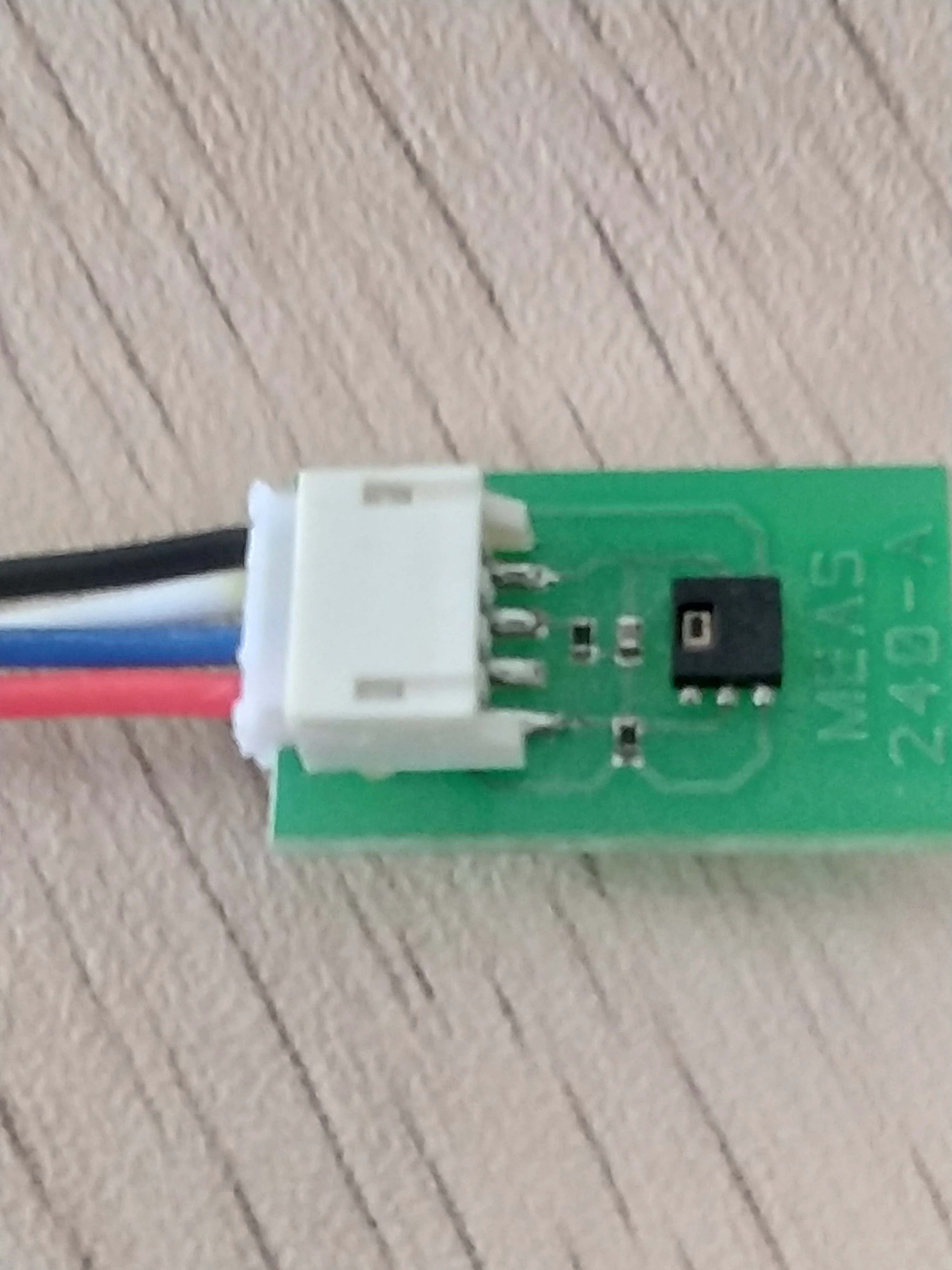

HTU21D sesnor with Nucleo-L152RE
  • December 18, 2018
  • 18 replies
  • 5306 views
I am newbie to use Nucleo-L152RE board. I have a HTU21D-Temperature & Humidity sensor which used I2C interface to read the temperature data.

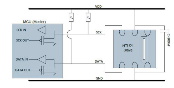

Every time getting the zero value from the sensor. So, can you please tell me what is the problem here?.

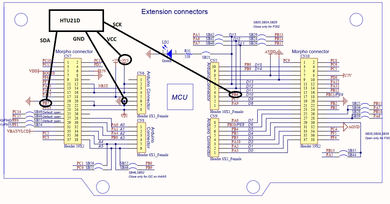

Connection of HTU21D sensor and Nucleo-L152RE board are:
SCK --> PB6
SDA --> PB7
VCC --> 3V3
GND --> GND

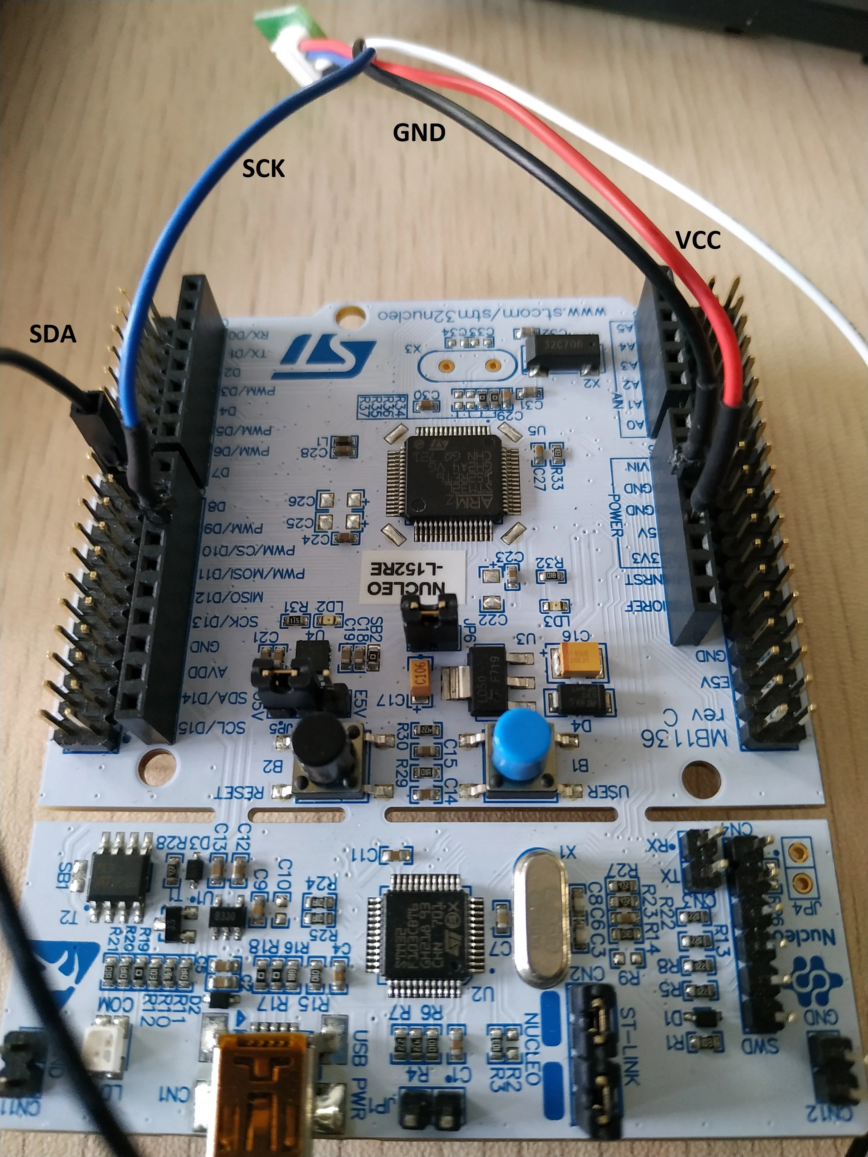

Attached snap shot of interface between sensor and Nucleo.

    Has anyone give me the solution for the i2c busy flag error?. Is there any pull-up/down setting required?. What is wrong here?. @Community members, can you please help me to resolved this issue.
    After Forever
    Senior III
    December 19, 2018
    I2C requires open-drain and pull-ups on both data and clock pins, if you don't have the pull-ups on PCB level you must activate them on MCU level.
    As for the busy flag, can you debug step-by-step into the HAL calls and see where exactly it returns the busy code?

    Did you generate the initialization code using STM32CubeMX? Can you share the IOC file? I don't see any calls to HAL_I2C_Init.
    AP_040
    AP_040Author
    Senior
    December 19, 2018
    Here is the IOC file. HAL_I2C_Init() is called in MX_I2C1_Init(), it is already present in code but unfortunate I forgot in snippet code.
    Also attched HTU21D interfcae which is already present pull-ups on I2C lines.0690X000006CsHnQAK.png

    • Here I attached full interface snapshot of NUCLEO-L152RE with HTU21D sensor and main.c file. In the snap -shot you can find that there is pull-ups present on SDA and SCK line. So, can you please guide me how to solve this issue to read proper temperature data.
