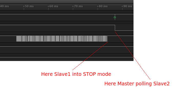

I am using I2C of STM32L476, and have one Master , two Slave device.
Slave1 will go into STOP mode, and need wake up by I2C.
Slave2 not be polling by Master every 100ms.
But after Slave1 into STOP mode, and Master polling Slave2 again,
The SCL will lock at low level,
Then, I can't wake up Slave1 by I2C, any one know why the SCL will lock at low level??

//if I mark this line the SCL will not lock at low level
if(HAL_I2C_Slave_Receive_IT(&I2cHandle, (uint8_t *)aRxBuffer, RXBUFFERSIZE) != HAL_OK){}
