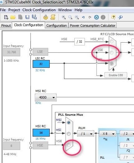

Hi, STM32Cube contains:
- STM32CubeMX - graphical software to design of microcontroller configuration and generating initialization code, it´s very useful for me in order wide application. For Win you can install STM32CubeMX
and under Linux there is Eclipse plugin.
- STM32Cube HAL - it´s new abstraction layer, ensuring portability across STM32 portfolio. Latest microcontrollers are not supported in STM Standard Peripheral Library and you have to use HAL ''library''

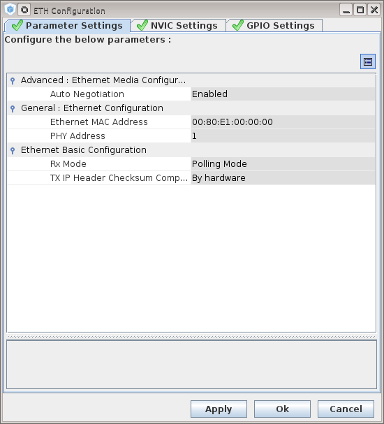

How can I initialize and use Ethernet (ETH): media access control (MAC) with
DMA controller on STM32F407 Discovery ?

l239955_stm1
Posted on April 15, 2015 at 08:59
I have no experience with stm32f4 and ETH but tool STM32CubeMX generate initialization code for all peripherals that you want to.
There is window in CubeMX with ETH setting
