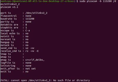

Thanks for sharing this..
     Here, we also struggling to resolve the same issue..
But i have tried with ubuntu linux machine.
      Could you please find the screenshot and let me know if any further process available to resolve this issue!!
   Thank in advance.
