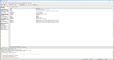

I soldered a new STM32 on the board, it can enter bootloader, but it's under Readout protection(I guess I bought renovated chip), I don't know how to unlock Readout by STM32CubeProgramer, finally, I use STVP and ST-LINK V1 to connect through SWD, and change the option byte, unlock Readout protection.

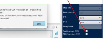

So try with unprotect enabled, here ->

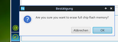

Can you connected in bootloader do a : full erase chip, or mass erase ?

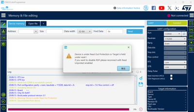

I supposed I can, we should able to unlock by erase the whole chip, but seems I can't, it alway display a small window says"the chip is readout protected...", if I close it, and click wherever, it shows up again.
I will try it again when I am home, and paste screen shot here.
STM32CubeProgramer detect the MCU is Read out protected, then disconnect, so I can do nothing.
I can use STVP with ST-LINK through SWD to modify option byte.
Is it possible to use ST utility to modify option byte through UART?
It works, thanks.
