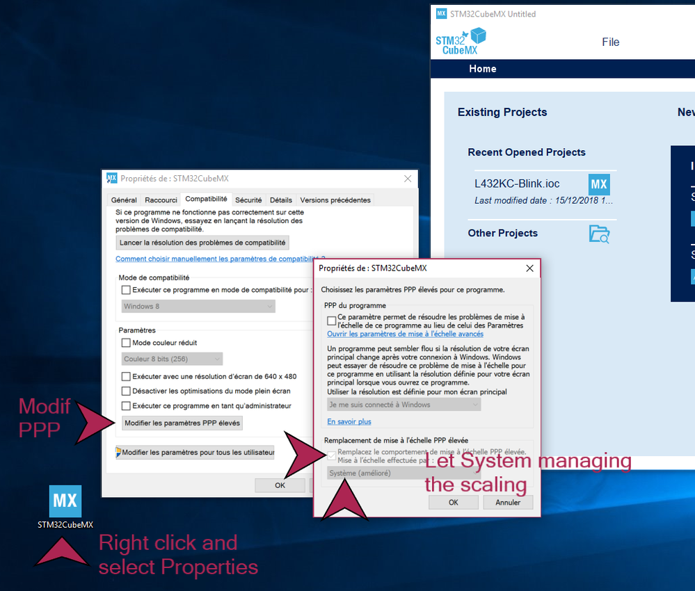

I installed CubeMX. It works but the font of the editor is so tiny that it is not possible to use it. How to enlarge the font of the CubeMX Editor?

I have finally found a solution under Windows 10: let the system to manage the scaling of the application STM32CubeMX cf. screenshot below.
