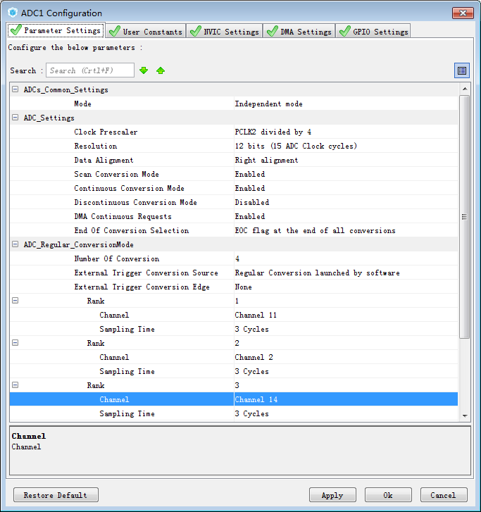

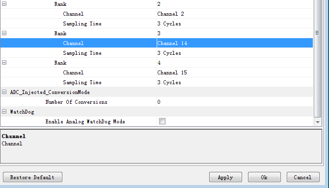

If you want to read multi-channel-adc, DMA Mode maybe the better way to do it, for example
PC1 ------> ADC1_IN11,
PC4 ------> ADC1_IN14,
PA2 ------> ADC1_IN2,
PC5 ------> ADC1_IN15
1. ADC Initial : for channel with 4 different rank

/**Configure for the selected ADC regular channel its corresponding rank in the sequencer and its sample time.
sConfig.Channel = ADC_CHANNEL_14;
sConfig.Rank = 3;
if (HAL_ADC_ConfigChannel(&hadc1, &sConfig) != HAL_OK)
Error_Handler();
sConfig.Channel = ADC_CHANNEL_15;
sConfig.Rank = 4;
Error_Handler();

4. Read Multi-ADC-Channel to memnory
static uint16_t adc_buffer[4];
hadc1.Init.NbrOfConversion == 4
if(HAL_ADC_Start_DMA(&hadc1, (uint32_t*)&adc_buffer, hadc1.Init.NbrOfConversion) != HAL_OK);
HAL_Delay(500);
HAL_ADC_Stop_DMA(&hadc1);
and add what you want in completed callback function:
* @brief Conversion complete callback in non blocking mode
* @param AdcHandle : AdcHandle handle
* @note This example shows a simple way to report end of conversion, and
* you can add your own implementation.
* @retval None
void HAL_ADC_ConvCpltCallback(ADC_HandleTypeDef* AdcHandle)
// TODO
__NOP();

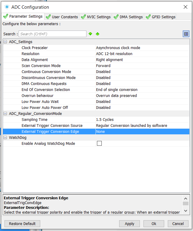

Not a HAL guy, but pretty sure you'd need to increment the Rank number
Posted on April 17, 2017 at 12:50
The rank number appears as a fixed number in the HAL of the ADC:
♯ define ADC_RANK_CHANNEL_NUMBER , , , , , , , , , , , , , , , , (0x00001000U) , /*!<, Enable the rank of the selected channels. Number of ranks in the sequence is defined by number of channels enabled, rank of each channel is defined by channel number (channel 0 fixed on rank 0, channel 1 fixed on rank1, ...) */
It is not clear to me how does it work or how could I change it.

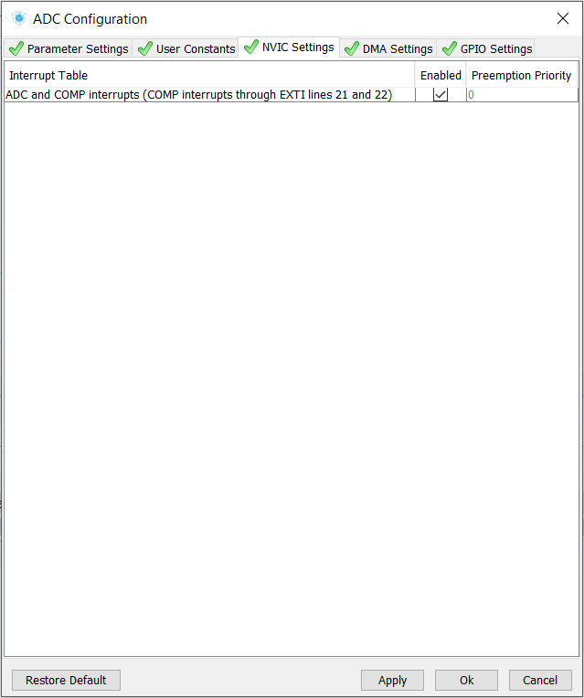

Posted on April 26, 2017 at 11:37
I think the MCU I'm using is more limited than yours. This is what I can configure in CubeMX:
I haven't find any way to configure different ranks for each ADC channel. What I have finally done is to enable the ADC interrupts and work in interrupt mode:
It seems to work fine but I would like to know if there is any way to us the DMA as well.
